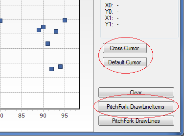

I've attached a sandbox app (forgive all the extra non relevant junk in it )
Steps to replicate my problem.
Click Cross cursor and drag the mouse over the chart .. you'll see a cross
Click default cursor and drag the mouse over the chart .. the orignal cursor returns.
now ..
Click the cross, drag the cursor .. you'll see the cross
Click Pitchfork DrawlineItems and drag the pitchfork out .. you still have the cross
now click default cursor and voila you still have a cross.
My main app has the same behaviour even with one drawline ... I swear I'm not going mad and seeing things ... well no more than usual ...
