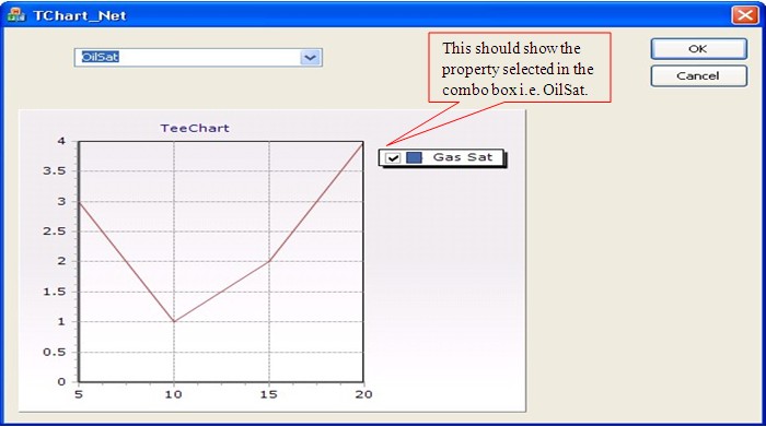

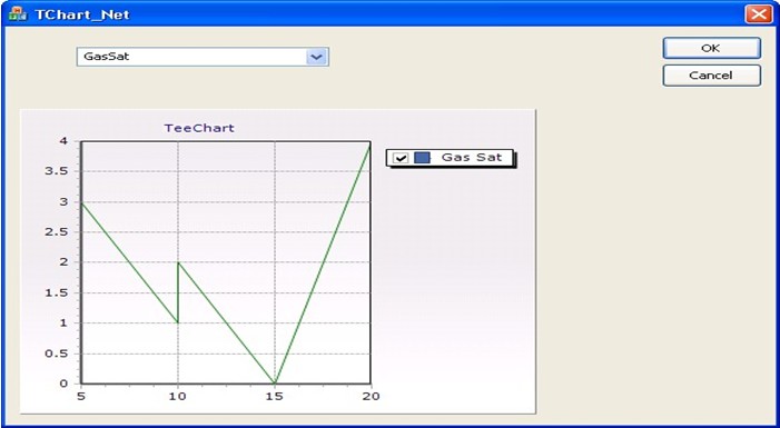

We are trying to upgrade our application from TeeChart v2 to TeeChart v4. We are facing a problem in Steema Tee Chart v4 that was working correctly in TeeChart v2.
There is a combo box containing various names of properties. On selecting any property in the combo box the legend series should display the properties name as series title. For the first time when the chart is drawn the title is shown correct as shown in ScreenShot1.jpg while the series title on the legend does not get updated with the series name as shown in ScreenShot2.jpg. Snapshots are attached for the same.
The code for the selection change is pasted below:
private void comboBox1_SelectedIndexChanged(object sender, EventArgs e)
 	int PropIndex = comboBox1.SelectedIndex;
	tChart1.Series[0].Clear();
        tChart1.Series[0].ShowInLegend = false;
	for(int i=0;i<5;i++)
	 	switch(PropIndex)
	               case 0:
                           tChart1.Series[0].Title = "Oil Sat";
                           tChart1.Series[0].Add(oilValues[i], i, Color.Brown);
                           break;
	               case 1:
                           tChart1.Series[0].Title = "Gas Sat";
                           tChart1.Series[0].Add(gasValues[i], i, Color.Green);
                           break;
                       case 2:
                           tChart1.Series[0].Title = "Water Sat";
	                   tChart1.Series[0].Add(waterValues[i],i,Color.Blue);
	                   break;
          tChart1.Series[0].ShowInLegend = true;
          tChart1.Refresh();

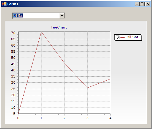

Your application seems to works as expected for me here.
I've ran it in Debug mode, and I've seen that when the application starts, the line:
comboBox1.SelectedIndex = 0;
makes the "comboBox1_SelectedIndexChanged" method to be executed. And I've see how the process enters to the case 0:
                    case 0:
                            tChart1.Series[0].Add(i, rnd.Next(100), Color.Brown);
                            tChart1.Legend.Symbol.Pen.Color = Color.Brown;
                            break;
And when the form is shown, I can see the "Oil Sat" line:

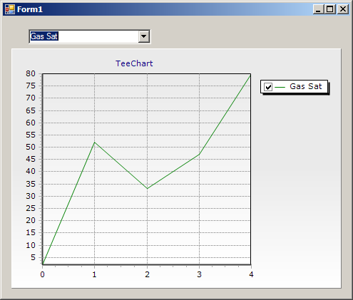

And if I select "Gas Sat" in the combobox, I can see how the process goes into the "comboBox1_SelectedIndexChanged" method again, executing the case 1:
                    case 1:
                            tChart1.Series[0].Add(i, rnd.Next(100), Color.Green);
                            tChart1.Legend.Symbol.Pen.Color = Color.Green;
                            break;
And the it is shown the correct chart too:
