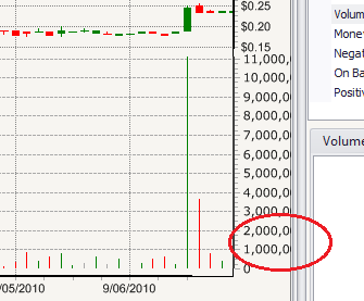

Greetings,
I have a tricky one ... my Right Axis (Which is axis.left and axes.left.otherside = true)
All working as expected ..
However when I add a custom axis to the right ... it does not adjust to allow room for the scale values. (see below)
I have set the axis to automatic
            StockChart.Axes.Left.Automatic = true;
            StockChart.Axes.Bottom.Automatic = true;
But no luck there ... is there a property I am not setting that will enable the chart to adjust accordingly?
Cheers Phil.

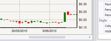

But it still overestimates the Label size and not by any constant value that I could adjust the Margin value by .. i.e. 50%
When I first open my chart the axis labels render like so
When I add a custom axis with much larger labels the spacing doesnt change.(but by luck happens to fit)
When I change to another instrument that has larger labels I again have quite a gap
Does it matter that my 'Right Axis' is actually the 'Left Axis' with the 'otherside' property set to true?
I'm guessing the main problem I am having is that it is calculating a far bigger label size than is actually being drawn.
And I am assuming that I need to do this routine for EVERY vertical axis and Custom axis.
Cheers Phil.
