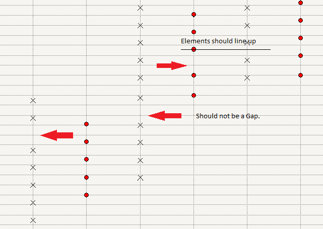

NOW down to business ... please refer to the below image.
Incorrect drawing of a point and figure.
PointFigure Bug.png (12.15 KiB) Viewed 5846 times
This looks like a bug ... in 1) alignment of the boxes (circles and X's) and 2) there are 'gaps' in the stacking.
If this is not actually a bug can you please tell me what settings would effect the Point and figure chart this way.

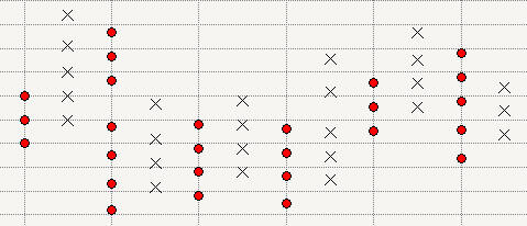

And just in case here's what Point and Figures traditionally look like ...
PointFigure Example.png (5.04 KiB) Viewed 5842 times
Cheers Phil.

Hi Snarkle,
I'm trying to reproduce it with the following code but I can't. Could you please change it so we can reproduce it here?
            Steema.TeeChart.Styles.PointFigure series1 = new Steema.TeeChart.Styles.PointFigure(tChart1.Chart);
            series1.Add(9, 10, 3, 5);
            series1.Add(9, 8, 5, 6);
            series1.Add(6, 8, 4, 5);
Snarkle
Posts: 91
Joined: Wed Jun 30, 2010 12:00 am
Re: Point & Figure - can't populate the series ..
Post by Snarkle » Mon Aug 16, 2010 12:32 am
Not enough data for a series P&F Try this ...
            StockChart.Aspect.View3D = false;
            Steema.TeeChart.Styles.PointFigure series1 = new Steema.TeeChart.Styles.PointFigure(StockChart.Chart);
            //series1.Add(9, 10, 3, 5);
            //series1.Add(9, 8, 5, 6);
            //series1.Add(6, 8, 4, 5);
            series1.FillSampleValues(1000);
            series1.BoxSize = 20;
You'll see the graph render something like this.
Cheers Phil.
Posts: 9715
Post by Yeray » Mon Aug 16, 2010 9:04 am
Hi Phil,
Thanks for the sample. Now I've reproduced it and added to the defect list to be fixed in future releases (TF02015088).
