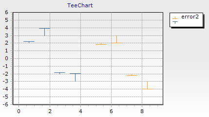

Steps to reproduce:
Private Sub Form1_Load(ByVal sender As System.Object, ByVal e As System.EventArgs) Handles MyBase.Load
    Dim errorSeriesH As Styles.Error
    Dim errorSeriesL As Styles.Error
    With TChart1
      .Aspect.View3D = False
      errorSeriesH = DirectCast(.Series.Add(New Styles.Error(.Chart)), Styles.Error)
      errorSeriesL = DirectCast(.Series.Add(New Styles.Error(.Chart)), Styles.Error)
      errorSeriesH.ErrorStyle = Styles.ErrorStyles.Top
      errorSeriesL.ErrorStyle = Styles.ErrorStyles.Bottom
      .Axes.Left.Automatic = False
      .Axes.Left.Maximum = 6
      .Axes.Left.Minimum = -6
    End With
    errorSeriesH.Add(1, 2, CorrectErrorValue(2, 0.2))
    errorSeriesH.Add(2, 3, CorrectErrorValue(3, 1))
    errorSeriesH.Add(3, -2, CorrectErrorValue(-2, 0.2))
    errorSeriesH.Add(4, -3, CorrectErrorValue(-3, -1))
    errorSeriesL.Add(5, 2, CorrectErrorValue(2, 0.2))
    errorSeriesL.Add(6, 3, CorrectErrorValue(3, 1))
    errorSeriesL.Add(7, -2, CorrectErrorValue(-2, 0.2))
    errorSeriesL.Add(8, -3, CorrectErrorValue(-3, -1))
    [b]TChart1.Legend.Inverted = True[/b] ' this causes the error
  End Sub
Result:
see attached image

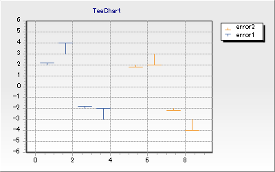

Post by Narcís » Wed Jun 23, 2010 7:44 am
Hi CitoICT,
Code below works fine for me here using latest TeeChart for .NET 2010 release available as you can see here:
Which TeeChart version are you using? Can you please try using latest release published this week?
      Steema.TeeChart.Styles.Error errorSeriesH = new Steema.TeeChart.Styles.Error(tChart1.Chart);
      Steema.TeeChart.Styles.Error errorSeriesL = new Steema.TeeChart.Styles.Error(tChart1.Chart);
      errorSeriesH.ErrorStyle = Steema.TeeChart.Styles.ErrorStyles.Top;
      errorSeriesL.ErrorStyle = Steema.TeeChart.Styles.ErrorStyles.Bottom;
      tChart1.Axes.Left.SetMinMax(-6, 6);
      errorSeriesH.Add(1, 2, CorrectErrorValue(2, 0.2));
      errorSeriesH.Add(2, 3, CorrectErrorValue(3, 1));
      errorSeriesH.Add(3, -2, CorrectErrorValue(-2, 0.2));
      errorSeriesH.Add(4, -3, CorrectErrorValue(-3, -1));
      errorSeriesL.Add(5, 2, CorrectErrorValue(2, 0.2));
      errorSeriesL.Add(6, 3, CorrectErrorValue(3, 1));
      errorSeriesL.Add(7, -2, CorrectErrorValue(-2, 0.2));
      errorSeriesL.Add(8, -3, CorrectErrorValue(-3, -1));
      tChart1.Legend.Inverted = true;
    private static double CorrectErrorValue(double y, double err)
      return (y > 0) ? err : System.Math.Abs(err) * -1 + y;
