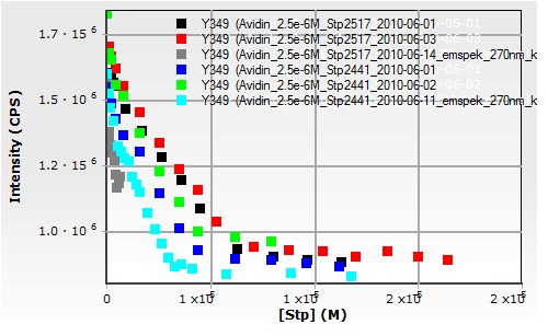

the following wrong axis scale occured:

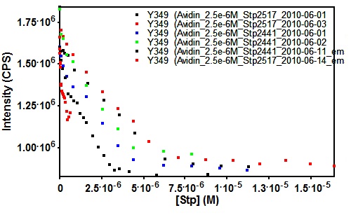

Correct axis scaling should look like this:

What is wrong?

test_1.jpg was created with my own chart component (programmed in delphi). Since I can not use it in VB .net I decided to buy TeeChart. But your answer implies that I cannot use TeeChart until the next release since such basic scaling errors are not acceptable. Please note, that these errors are obvious in both horizontal and vertical axis. Additionally, even disabling the exponential option and using other exponential format strings do not work correctly. An empty string comes nearest to the expected (x-Axis, but also not acceptable).
As I mentioned above, with such basic scaling errors I cannot use TeeChart. So I would be glad if you could provide a workaround.

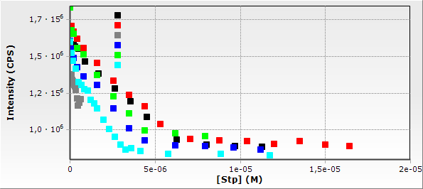

Try:
      tChart1.Import.Template.Load(@"C:\test\test.ten");
      tChart1.Axes.Bottom.Labels.Exponent = false;
      tChart1.Axes.Bottom.Labels.ValueFormat = "g";
      tChart1.GetAxisLabel += new GetAxisLabelEventHandler(tChart1_GetAxisLabel);
    void tChart1_GetAxisLabel(object sender, GetAxisLabelEventArgs e)
      if (e.LabelText.Contains("e-21")) e.LabelText = "0";
This gives me the image attached:
TF02014988 is still open and will be looked at in a future maintenance release.
