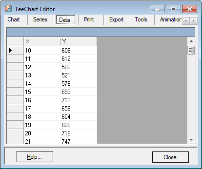

BTW, previously another bug encountered. Put a chartcontroller to the form and connect it with the chart. Here is the modified code:
    Dim fl1 As FastLine = Nothing
    Dim fl2 As FastLine = Nothing
    Private Sub Button1_Click(ByVal sender As System.Object, ByVal e As System.EventArgs) Handles Button1.Click
        If fl1 Is Nothing Then fl1 = New FastLine(Chart1.Chart)
        If fl2 Is Nothing Then fl2 = New FastLine(Chart1.Chart)
        fl1.FillSampleValues(110)
        fl2.FillSampleValues(100)
        Chart1.Invalidate()
    End Sub
    Private Sub Button2_Click(ByVal sender As System.Object, ByVal e As System.EventArgs) Handles Button2.Click
        fl1.Delete(0, 10)
    End Sub
Now execute the chart editor, chose on the series tab fastline1, then click the data tab: The deleted points are still there.
This works fine for me here using latest TeeChart for .NET 2010 release available as you can see here:
