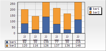

doing by using ControlChars.NewLine or vbCrLf ( i am using vb.net, so that was the reason probably \n did not work). But now i am facing another issue. I am using data table tool and doing this is inserting empty rows in that . So for example if in my label i am giving one carriage return that in data table also its inserting one empty row , if i m giving twoe carriage return that in data table also its inserting two empty row like this-
bar1 66 88
bar2 88 99
Re: how to wrap series labels
Post by Sandra » Wed Feb 24, 2010 12:02 pm
Hello shikha,
Using last version 4 and last version 3 of TeeChart.Net, chart appears next image using this code:

Chart with v4 and v3 TeeChart.Net
Please, could you say if this is your problem?
If it isn't your problem, please you could send us a simple project, because we can reproduce your problem here.

EXACTLY.. this is the issue i am facing!!!
