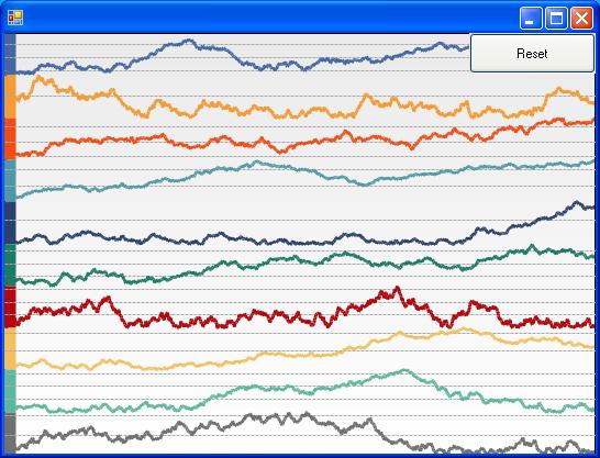

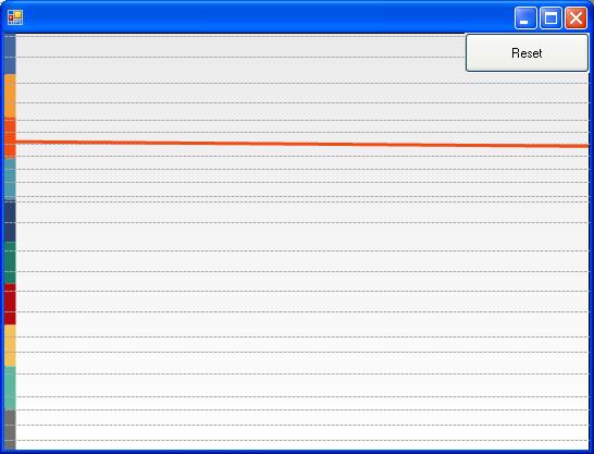

I have made a small example so that you can understand the problem.
Below are few screen shots of the application.
Before zooming - (Look at the custom axises at the left side)
After zooming - (Number of custom axis visible is still 10. although only one series is visible.)

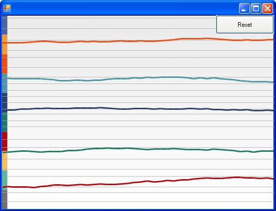

One more screeshot below -
Here also - all the custom axises are in the same position even though the series associated with few of the custom axises are not visible (Out of visible area).
What we need is - the custom axises should be resized based on the series data values.
If the series is fully visible then the custom axis should be there with proper size. If only one series is visible then the custom axis associated with that series should be the only axis visible and should take the whole area. Means the start and end position should be - 0 and 100.
Similarly, now if 2 data serieses are visible and some portion of a third data series is visible then the custom axis size that is associated with the data series that is partially visible should not be of the same size as other axises.
In that case the custom axises size should be based on the data series visibility.
