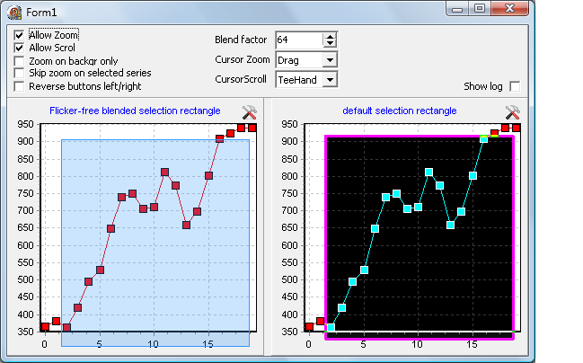

Please find attached demo with new class TAlphaBlendZoom, which I drafted for myself some time ago. It covers all wishlist items I mentioned above.
Included class TAlphaBlendZoom replaces original Zoom procedure in TeeChart, and slightly patches Pan.
Demo shows:
1. make Zoom alpha-blended
2. add onScrolled event
3. make Left mouse and Right mouse buttons interchangeable.
4. shows patch to Chart.pas 'MouseMove' procedure to allow unlimited mouse dragging
5. Introduces properties ZoomingCursor and PanningCursor (cursors to show while Zooming/panning)
odissey1
Demo shows:
