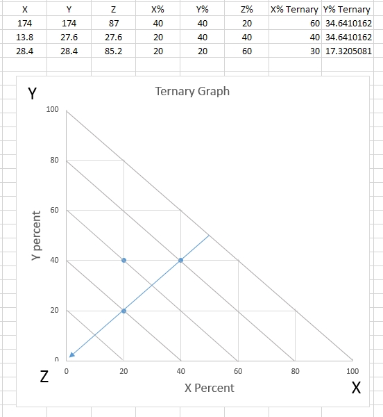

The current Ternary Series implementation in TeeChart needs a revamp. It does not suit a lot of users who wish to plot data in a similar format to a regular X-Y plot, without having to implement a lot of special code. A ternary plot is basically an X-Y plot, as there are only 2 independent variables (Z is always equal to 100 - X% - Y% where X% = X/(X+Y+Z)*100 and Y% = Y/(X+Y+Z)*100). This means there is no need to use 3D charting code. In fact, ternary data can be plotted on a simple X-Y chart, but it doesn't look so good and is less easy to understand, so special triangular axes are employed.
I have attached a spreadsheet which shows my thinking. On the first spreadsheet, data is plotted on a simple X-Y plot. The Z-axis is in the direction of the blue arrow, at right-angles to the diagonal edge of the chart. As you can see, the Z-values are correctly located at 80, 60 and 40% respectively, as shown below.

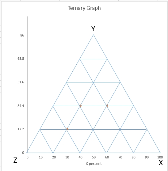

In the second sheet, I have drawn sloping "axes", and again plotted X-Y data. To do this, the X% and Y% values need to be recalculated using the following formulae:
X% Ternary = X% + Y% * cos(60°)
Y% Ternary = Y% * sin(60°)
Examining the chart, it is clear that the X%, Y% and Z% values are plotted correctly.
