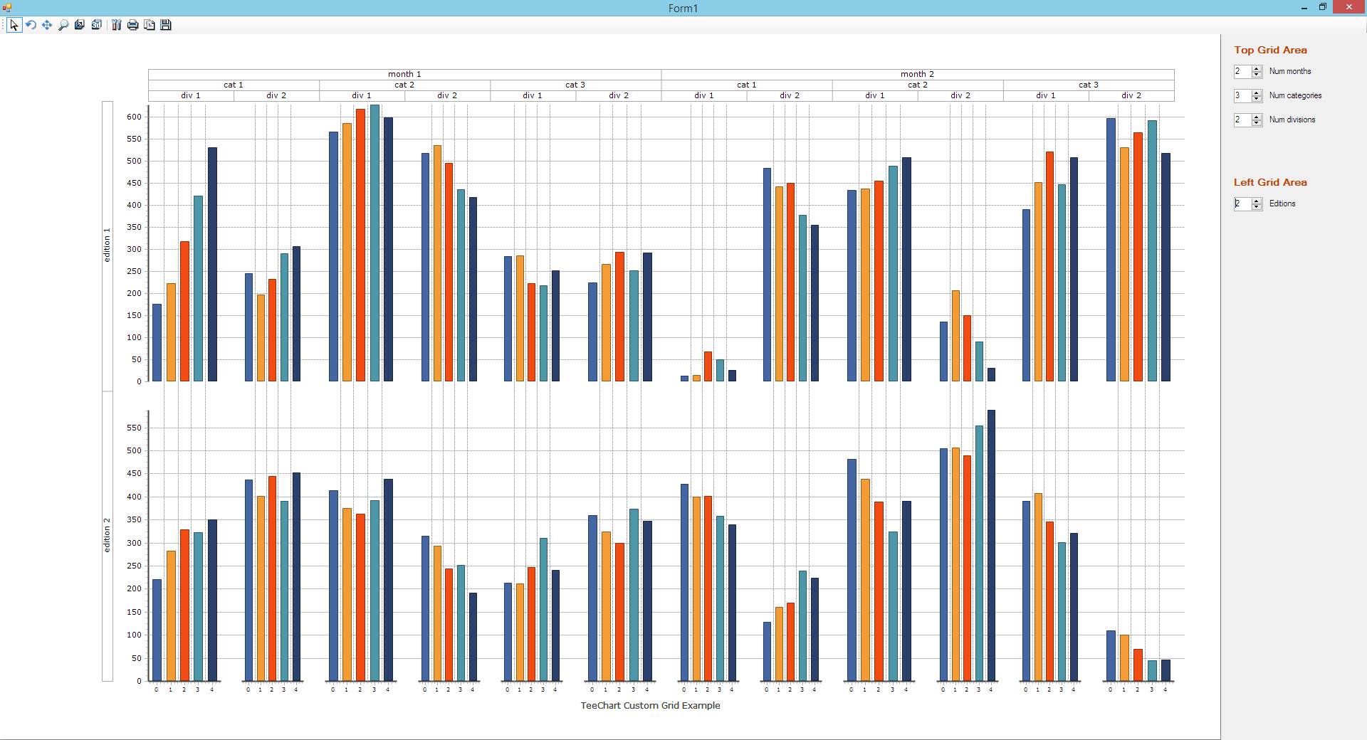

There's been some years since I made an user interface with a dynamically generated chart (or group of it) that between other things presents labels in a grid form in order to group some descriptions. I made it by calculating spaces occupied for each point and resizing the grid (other control) rows and columns. This works fine but as you can imagine, export it was impossible.
Is there any chance that this kind of charts was part of TeeChart functionalities set?
I've attached a simple demo, one of the possible chart, but the application can generate a lot more charts.
thank you in advance

Is this something similar to the SubAxes property available in TeeChart VCL? You can find it here searching for SubAxes. If I'm not wrong, you are a TeeChart for .NET user. Is that correct?

yes it is something similar to Sub axes, and yes, I'm a .NET user, even when the images belong to a vb6 application (com control).

We've prepared a demo that shows some of what can be done with the current version of TeeChart.
The example uses custom drawing to the canvas to create grid and labels and uses custom axes to define the chart zones.
http://www.steema.com/files/public/WinF ... iChart.zip
All contents of the chart including grids are available for direct output to printer.
The image shows the application output.
An alternative option to custom axes could be to use the TeeChart SubChart tool to define Chart areas. The feature requested would make a useful addition to the Chart and is being reviewed for inclusion directly to the chart itself.

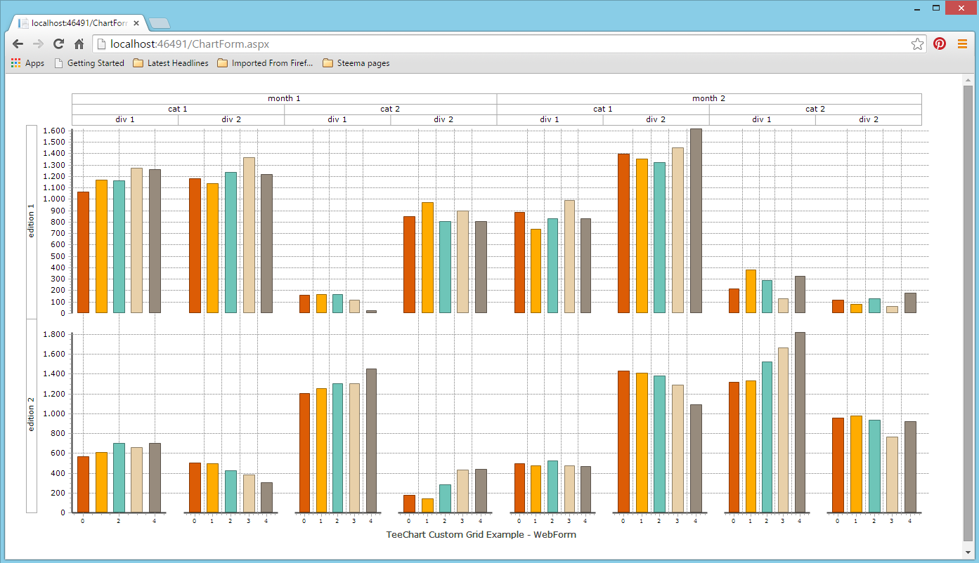

As a followup. Copy pasting the Winform code into a WebForm (re-assigning the AfterDraw event to the WebChart) gives this output to the browser:
The variables (Month, Category, Division and Edition) have been fixed for expediency and the colour palette has been changed to 'Seawash' to add a little variety.
