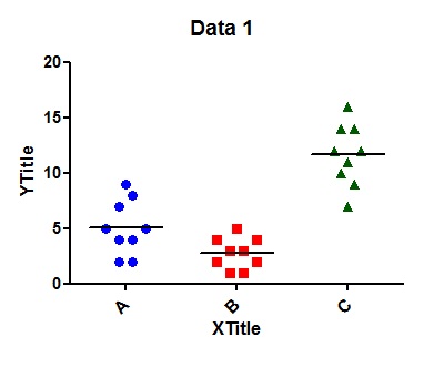

I am wondering if it is possible to implement dot plots (similar to the attached charts) in future Teechart releases. Two different types would be nice, aligned and scattered (as shown) points to avoid overlapping. Line may represent mean, median or custom value.
May be there is a workaround to produce such charts with the current Teechart version, and I would appreciate any guideance to do so.

You could use three Points series. One in blue with Circle pointer, one in red with the default Rectangle pointer and one in green with Triangle pointer.
Then, you could use three functions, one linked to each series.
I wouldn't expect to find too much problems with it. I guess I'm missing something. Maybe what you want is an algorithm to, given an YValues set, sort the XValues so the points occupy the minimum space without overlapping. Is that what you meant?

thanks for your hint on using Points series. I was indeed able to make the dot plots as I wanted them. For the scattered dot plots, I just randomized the xvalues in a range of plus/minus 40%, for example for x=1, I get a new random x values between 0.6 and 1.4. I have not thought about checking the distance of each point to each other avoiding overlapping. Instead I was thinking to make the Pointer.Brush.Color=Transparent and Pointer.Brush.Solid=True. In this case, overlapping points should be still distinguishable, unless pointers are completely overlapping.
