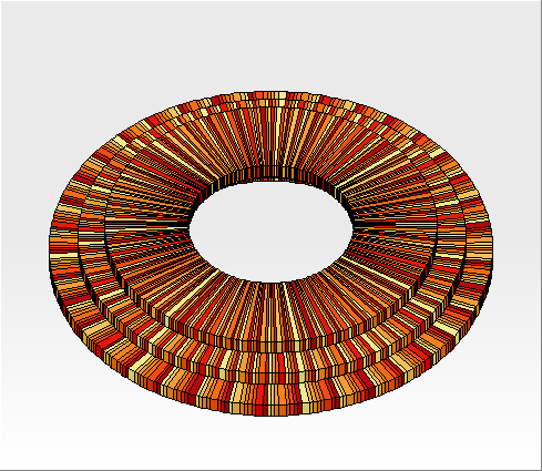

Re: Can the colour of the Donut pie be user-defined?
Helo Milan,
In the following example I've modified the sources for not to call the SetOtherCustomRadius function when a radius is modified. So the picture below is how it will look when [TV52015814] will be applied. Without this modification, the donuts have the same radius.
Is this something similar to what you are trying to achieve?
This can be done modifying the ChartRect in a similar way than in the "Multiple Pies" example mentioned before, but adjusting all the rects to have the same Left and Right positions but slightly different positions in Top and Bottom.MilanN wrote:I have been experimenting with the Donut chart for a while now. One of the observations I made is that, when I inserted multiple pies in the same tChart element, the 3rd donut onwards would automatically get placed besides the first one. Can the donuts be placed one over the other? I know that placing it in a Rectangle before drawing is an option, but can they be placed like concentric circles with the same axis and/or the same centre. Because when you place them in different rectangles and change the tChart.Aspect.Elevation to look at it at a different angle, you see them placed one beside the other.
Can you suggest anything for placing the donut charts concentrically ?
This is by design. When one donut X or Y radius is modified, all the donuts are also modified to have the same proportions. I've added to the wish list the possibility to add a new property to control if you want all the donuts to have the same radius or not (TV52015814).MilanN wrote:One more observation that I made was that, when two donut charts were placed in the same tChart then, changing the XRadius of one would change the XRadius of the other. Can the XRadius of the two donuts be set differently ?
You could use one of the TeeChart palettes or create your custom palette to do this. For example you could use the WarmPalette.MilanN wrote:As I mentioned before, I want to assign different colours to the slices depending on the temperature. So is there any function that would provide a color gradient which would calculate the RGB values depending on the value of the temperature. If not, do you have any ideas for doing this.
Dear Yeray,
What I am trying to do is very much like what you interpreted. The only difference being that I am looking at making only 2 concentric donuts with different XRadius (one being smaller than the other) and 7 of the same arrangement in the same TChart or multiple TCharts, whichever looks more realistic. By realistic I mean, I am trying to make two extremely thin donut charts placed one inside the other so that it actually looks like an array of temperature sensors placed along the circumference of the furnace, one array inside and teh other outside. I did not totally understand how the colour palette can be used, I am using Tchart for .NET 2010 and working on Visual Studio 2010, how would I implement the Warm pallette in this environment. Could you guide with the instructions to be used. Also, how do I create a colour palette on my own?
By when will the new property [TV52015814] be added ? Can I do something so that the SetOtherCustomRadius is not called?
Thank You.
Milan
Thank You.
Milan

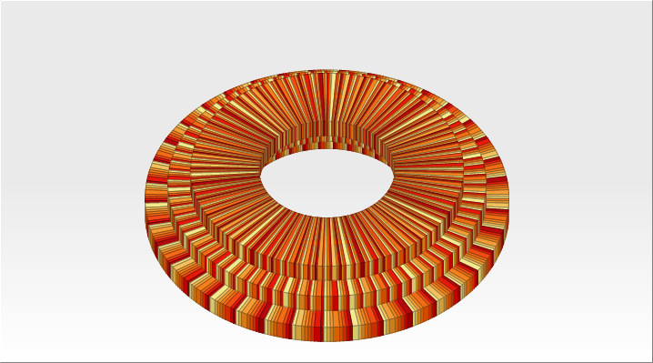

You can see another simple example of the palettes and custom palettes usage at "All Features\Welcome !\Themes\Custom Palettes" in the features demo program.
Here it is the code above translated to C# and the result I get with TeeChart .NET (using the new property UniqueCustomRadius):
Varying the ChartRect set in the BeforeDrawValues event you should be able to custom position and size your donuts where you wish. Looking at the simpler example in the features demo at "All features\Welcome !\Chart styles\Standard\Pie\Multiple Pies" you'll probably understand better how it works.MilanN wrote:What I am trying to do is very much like what you interpreted. The only difference being that I am looking at making only 2 concentric donuts with different XRadius (one being smaller than the other) and 7 of the same arrangement in the same TChart or multiple TCharts, whichever looks more realistic. By realistic I mean, I am trying to make two extremely thin donut charts placed one inside the other so that it actually looks like an array of temperature sensors placed along the circumference of the furnace, one array inside and teh other outside.
A palette is just an array of colors. In the example I just used a color or another from the palette depending on the index of the value and the series.MilanN wrote: I did not totally understand how the colour palette can be used, I am using Tchart for .NET 2010 and working on Visual Studio 2010, how would I implement the Warm pallette in this environment. Could you guide with the instructions to be used. Also, how do I create a colour palette on my own?

A new property UniqueCustomRadius (true by default) will be available with the next maintenance release. Setting it to false, the SetOtherCustomRadius won't be called when setting CustomXRadius or CustomYRadius properties.MilanN wrote:By when will the new property [TV52015814] be added ? Can I do something so that the SetOtherCustomRadius is not called?
