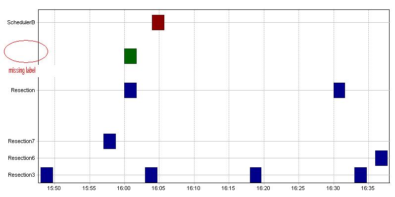

I have another problem.
we are using Gantt labels and add the data like this:
gLabel.Add( start, end, k, configuration );
I can see that "configuration" is set if I debug the code.
But with more than one entry the label is not shown in the chart.
I attached a screen shot.
I have no idea why the label isn't shown and hope you can help me.
Daniela

Re: missing label in chart
Hi daniela,
It would be helpful if you could send us a code sniped or a simple project we can run as-is here to reproduce the problem and try to find a solution.

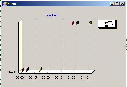

I made a small example:
for ( int i = 0; i < 2; i++ )
Steema.TeeChart.Styles.Gantt gantt1 = new Gantt();
Gantt gLabel = new Gantt();
tChart1.Series.Add( gLabel );
DateTime fstart = new DateTime( 2009, 6, 19, i, 0, 0 );
DateTime fend = new DateTime( 2009, 6, 19, i,1, 0 );
gLabel.Add( fstart, fend, i, "test" + i.ToString() );
fstart = new DateTime( 2009, 6, 19, i, 5, 0 );
fend = new DateTime( 2009, 6, 19, i, 6, 0 );
fstart = new DateTime( 2009, 6, 19, i, 20, 0 );
fend = new DateTime( 2009, 6, 19, i, 21, 0 );
tChart1.Refresh();
I get the attached chart, the second gLabel "test1" is missing.
I've modified your code introducing a little variant of the code that Sandra suggested to you and it seems to work fine here:
//Steema.TeeChart.Styles.Gantt gantt1 = new Gantt();
tChart1.Axes.Left.Labels.Items.Clear();
for (int i = 0; i < tChart1.Series.Count; i++)
tChart1.Axes.Left.Labels.Items.Add(tChart1[i].YValues[0], tChart1[i].Labels[0]);
tChart1.Refresh();
Thanks a lot, it works with the additional code
