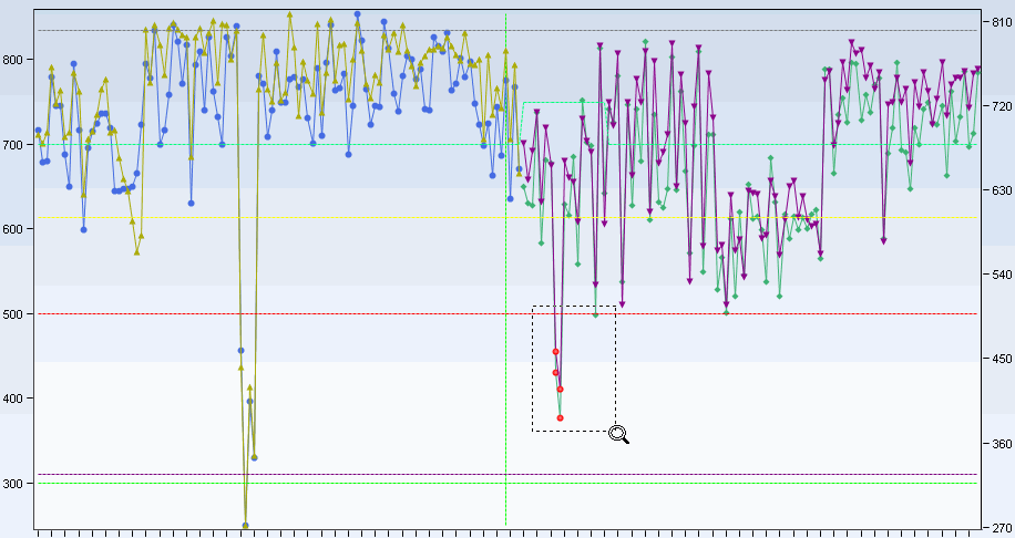

I want to highlight selected points after selection.
The way coming to my mind is to new a series of the selected points.
Then I could set the pointer style, color... any way I want to present the highlight.
But it seems not a good solution. Do you have any suggestion?

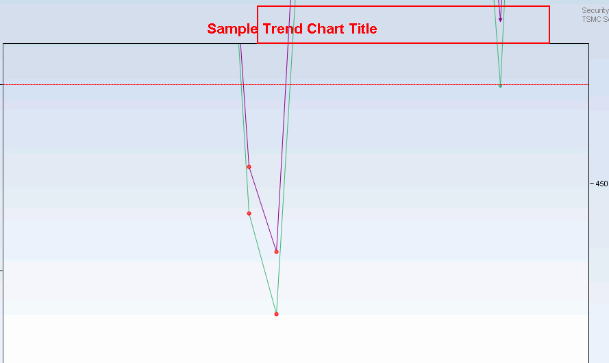

I enabled the zooming tool after highlighting but met some problems.
The line associated with the highlighted points would be drawed outside the chart region.

Re: Selection of series' points
Post by Sandra » Tue Jul 07, 2009 10:17 am
Hello Cris,
Do you have any iedas about this?
I have commented two things:
First:
Is possible that you have property tChart1.Aspect.ClipPoint= false, change this for true. I check with last version and works fine.
Second: If previous not works, please you could say what is your actualy version of TeeChartFor .Net?
If your version isn't laster, please update the version and tester code.If the problem still appears you can send a simple example because we can reproduce here. Now,you can attach your projecte direcly in the forums post.

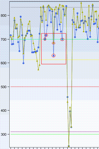

Coule I draw a circle on the outside of the pointer?
Please see the below image.
Post by Sandra » Fri Jul 17, 2009 12:56 pm
Hello Chris,
I find two solutions for draw a circle, in your selection. The first solution is more simple than the second, but both make a circle around the pointer.
