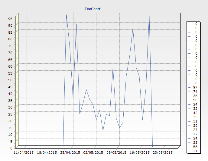

Re: DateTime and DbNull Values
Post by Christopher » Wed Apr 08, 2015 8:25 am
Yes, this works as expected in the latest publicly available version of TeeChart for .NET. Running the code Tommie posted gives this chart:
