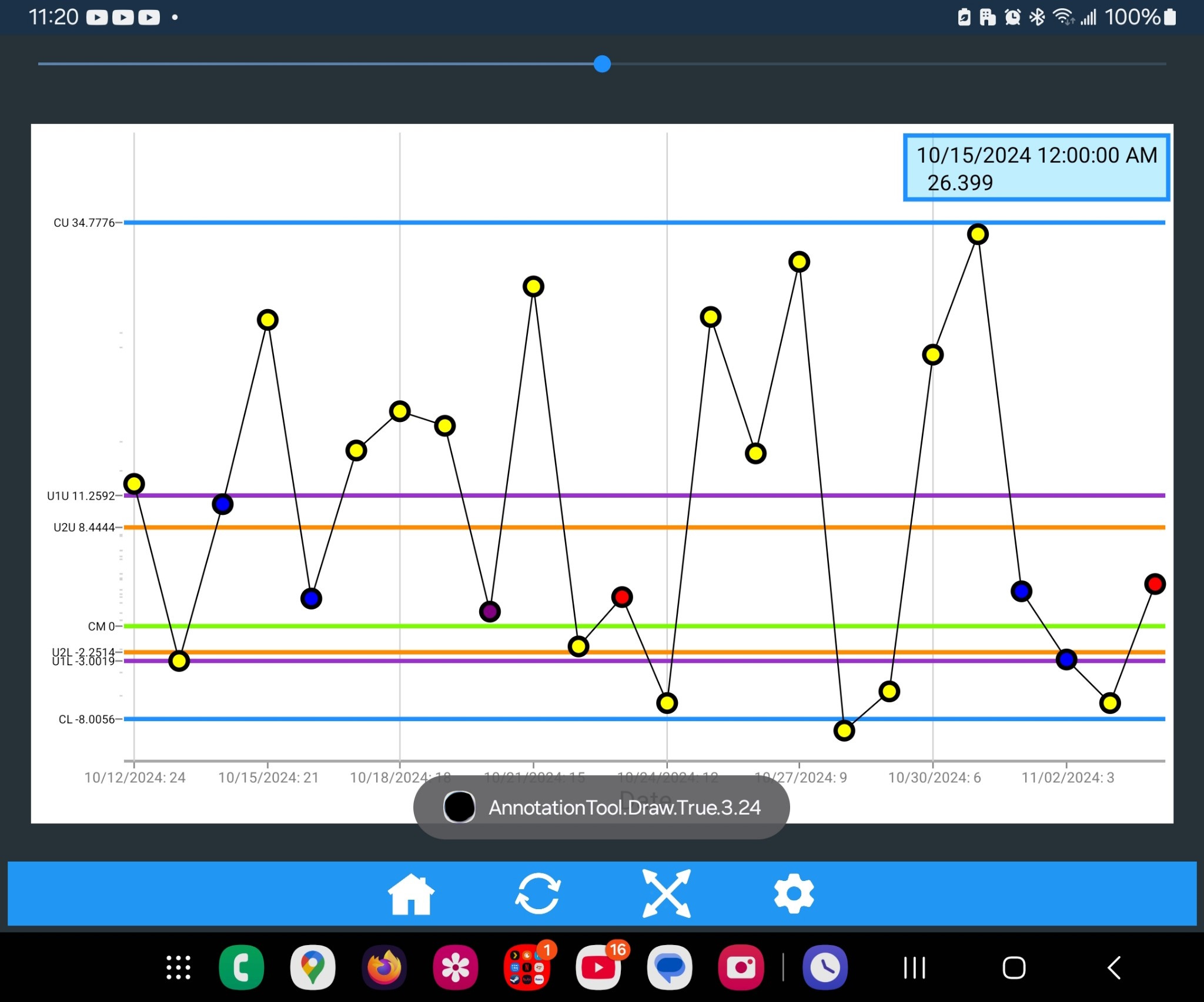

Here is a screenshot of so you can see it. The toast on the image is to help debug it.
In this case, the arrow should be from the bottom left corner of the popup to the 3rd point.
        #if DEBUG
            _ = Dialogs.Toast( $"{nameof(AnnotationTool)}.{nameof(Draw)}.{Active}.{currentPointIndex}.{line.Count}" );
        #endif

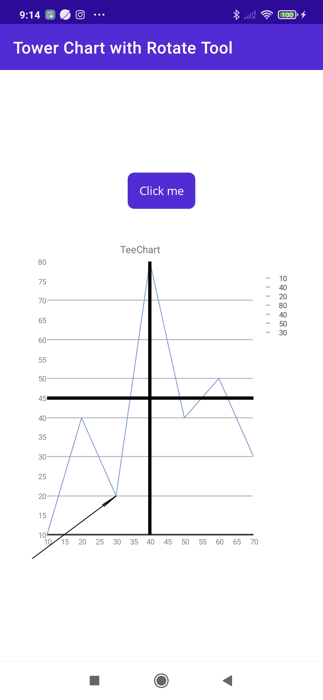

does the following code works for you ? it should draw an Arrow from left bottom corner to the third point in Chart.
        private void TChart1_AfterDraw(object sender, Steema.TeeChart.Drawing.IGraphics3D g)
            var series = tChart1.Chart.Series[0];
            int pointIndex = 2;  // Index 3
            double xValue = series.XValues[pointIndex];
            double yValue = series.YValues[pointIndex];
            int xScreen = series.CalcXPos(pointIndex);
            int yScreen = series.CalcYPos(pointIndex);
            int xStart = series.CalcXPosValue(0);
            int yStart = series.CalcYPosValue(0);
            g.Arrow(false, new System.Drawing.Point(xStart, yStart), new System.Drawing.Point(xScreen, yScreen), 3, 20, 0);
TLC

Pep
Posts: 3318
Re: Annotations are broken. Can't draw on the canvas.
Post by Pep » Mon Nov 11, 2024 8:23 am
which platform are you using?
Here it's working fine, just tested on Android or Windows.

Pep
Posts: 3318
Post by Pep » Tue Nov 12, 2024 2:30 pm
sure, here it's the code used:
        public MainPage()
            var line = new FastLine(tChart1.Chart);
            line.LinePen.Style = Steema.TeeChart.Drawing.DashStyle.Dash;
            line.Add(10, 10);
            line.Add(20, 40);
            line.Add(30, 20);
            line.Add(40, 80);
            line.Add(50, 40);
            line.Add(60, 50);
            line.Add(70, 30);
            tChart1.AfterDraw += TChart1_AfterDraw;

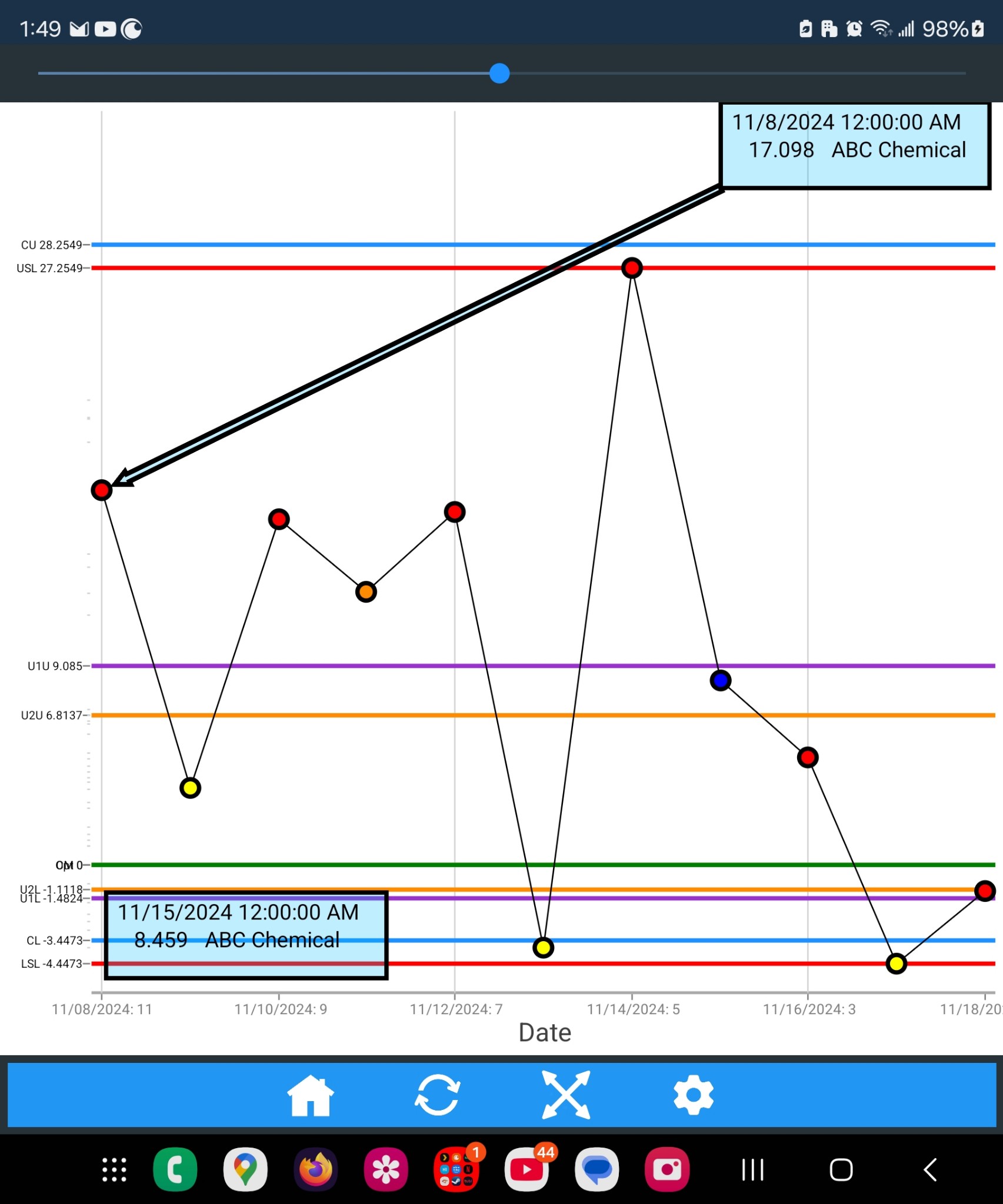

Not sure how, but got the arrow to show up. but as related to the issue Steema.TeeChart.Tools.NearestPoint Change event doesn't trigger http://support.steema.com/viewtopic.php ... e7a75ee146, it's always at the first point. doesn't change no matter where i click or drag.

TLC
Posts: 82
Joined: Mon Apr 08, 2019 12:00 am
Post by TLC » Tue Nov 19, 2024 8:07 pm
Somehow, the annotation popup hangs around after it is redrawn/invalidated. Only the most recent previous popup is visible aside from the current one. In otherwords, once you click again, it will remove the 2nd oldest, keeping the previous and draws the new one.
The arrow from is the current one, the other is the old one.
