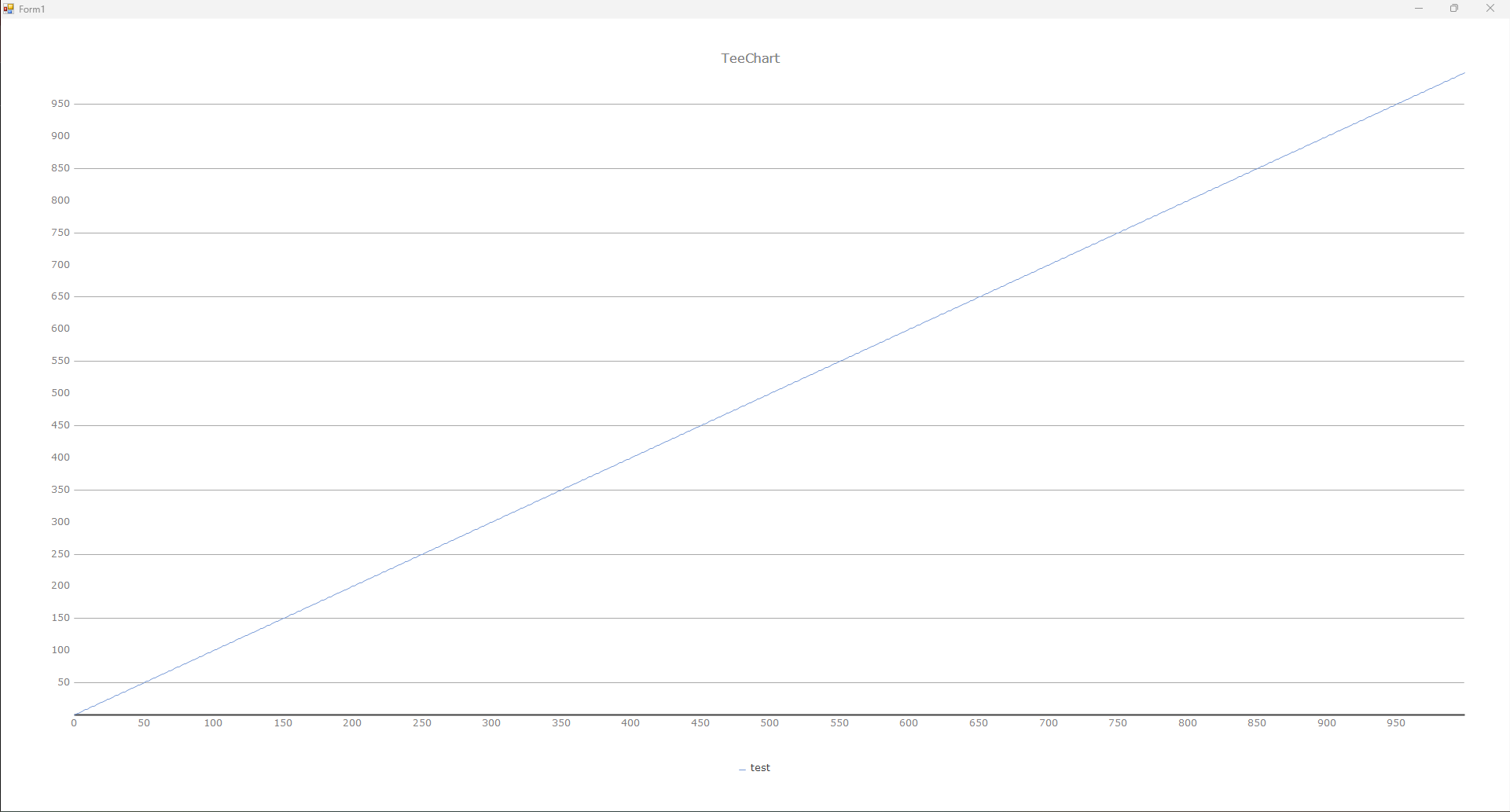

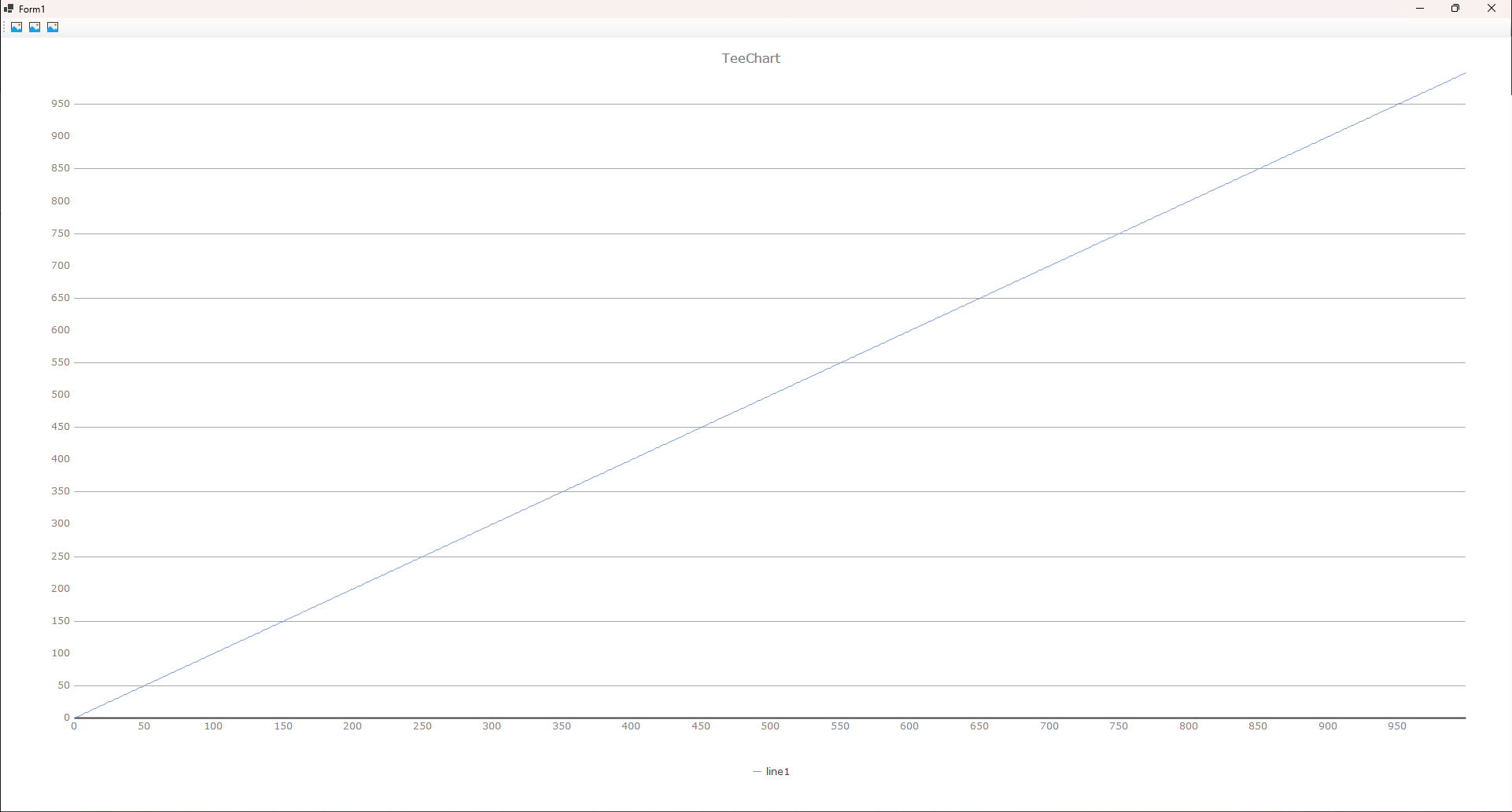

After loading a template file the series title does not get saved off correctly. This seems to work in ,netFramework but not in .net 6.0. In the two screenshots below the one in .net framework puts the Title to "test" whereas the on in .net 6.0 puts title to "line1"

Post by Rubén » Wed Jul 24, 2024 1:17 pm
thanks for feedback. We're working on fix it.
Regards, Rubén.
Rubén
Posts: 24
Joined: Fri Nov 19, 2010 12:00 am
Re: Importing data not setting the series title correctly (.net 6)
Post by Rubén » Wed Jul 24, 2024 4:20 pm
the problem has been resolved and the fix will be included with the next Nuget release.
