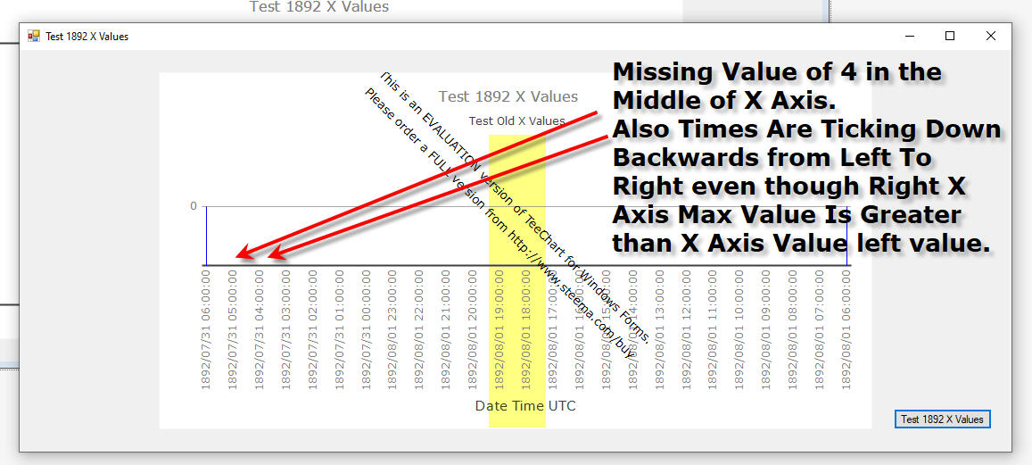

But I tried to run a chart yesterday with dates from 1892 and the Bottom (XValue) Axis doesn't show values in the middle of the XAxis.
Only values on the left and right sides of the chart show -- which is weird.
I've attached some screenshots and the sample project --
Thanks for your help.

thank you for your report. Seems like the issue is related to Microsoft's datetime zero
more here: https://learn.microsoft.com/en-us/dotne ... ew=net-8.0
We are currently checking for a solution or an interim workaround.

This is not something for which we can apply a quick fix to the code so we'll need to know a little about the type of use you envisage, ie. whether all your dates in a chart will be restricted to the pre Dec 1899 period or whether you expect a mixture of pre-post 1899 mixes in a single chart? ... or whether showing just whole day increments may be sufficient.
The problem (for us as chart designers) comes down to the date implementation by Microsoft for Windows. The zero date being midnight, 30 December 1899.
Note from the reference here:
For a chart merely showing whole days that is fine but to resolve that for each incremental fraction of the day requires inverting the fractional part of each integer (day) segment for any day-time data to plot correctly. We are looking at options.
In the meantime, an alternative option would be to set the x-values of the Series as non-datetime, simply numeric incremented values like 1,2,3 ..., and to set Labels either from an associated label table or calculating them according to a value algorithm.
We can work on an example for that if you're able to confirm a little about your intended use of the daterange.

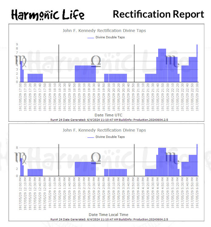

My website, HarmonicLife, figures out people's birth times given important dates in their lives -- ie Rectification.
So all of my charts are within one day.
Anyone born before 1899, ie historical figures, will run into this issue.
Julian's dates are doubles, so if I could use a double for X-Axis and then format the labels to UTC and Local Time, that would work, but I'd have to retool my reports, which will take time and testing, etc...

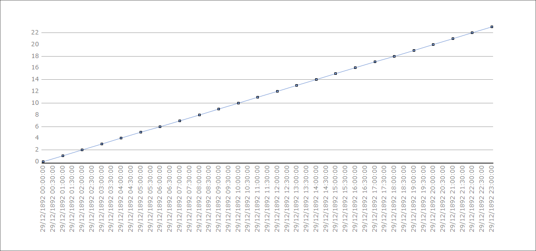

If your charts are showing one full day or less then we may have a straightforward solution, to invert the Axis.
This sample code for example:
Re:
We'll see if we can find a better generic solution.
DateTime startDate = new DateTime(1892, 12, 29, 0, 0, 0);
if (startDate.ToOADate() <= 0)
tChart1.Axes.Bottom.Inverted = true;
for (int i = 0; i < 24; i++)
DateTime currentDayTime = startDate.AddHours(i);
tChart1[0].Add(currentDayTime, i);
tChart1.Axes.Bottom.Labels.DateTimeFormat = "dd/MM/yyyy HH:mm:ss";

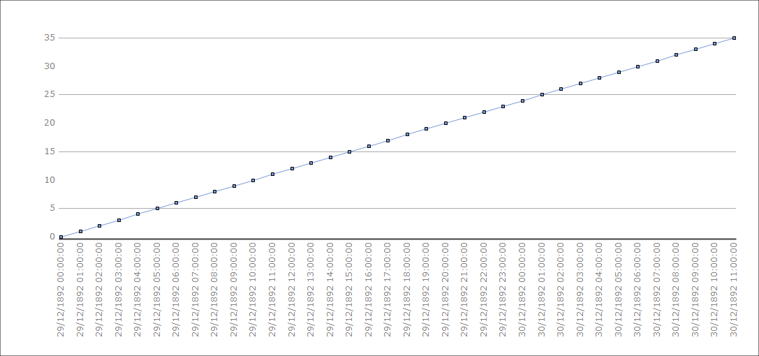

An alternative workaround suggestion: Assuming that the range for the x-axis could exceed one day then perhaps the easiest thing to do would be to move the dates to a workable range and then modify the year label.
ie.
I hope that something in there may prove useable.
ie.
bool pre1900 = false;
int dateYear;
startDate = startDate.AddYears(100);
dateYear = startDate.Year;
pre1900 = true;
for (int i = 0; i < 36; i++)
private void tChart1_GetAxisLabel(object sender, GetAxisLabelEventArgs e)
if ((sender == tChart1.Axes.Bottom) && (pre1900))
e.LabelText = e.LabelText.Replace(dateYear.ToString(), (dateYear-100).ToString());
