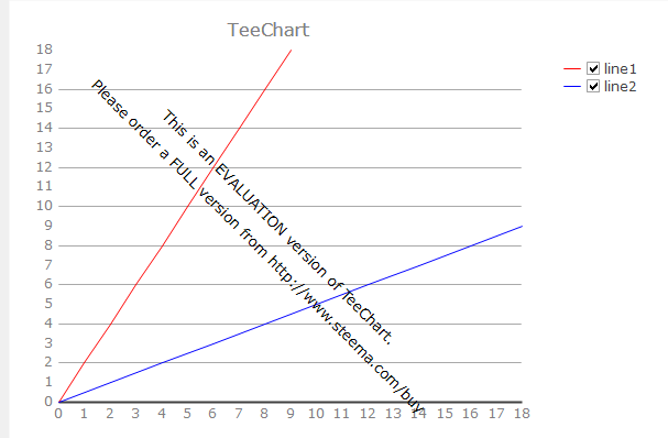

This code will create a chart like this one:
