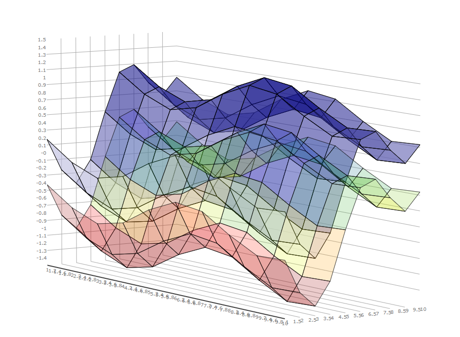

Hello, I am currently using Steema.TeeChart.NET.Avalonia (version 5.2023.10.27) in my project. I need to plot 2 surface series in the same chart. So far with only a single chart, it works smoothly without problems, but when I try to display 2 series at the same time, it seems that in some view angles, the two surfaces will overlap and not display properly. I try setting the transparency in the class Steema.TeeChart.Styles.Surface, but it still renders like a fully opaque object. I have searched and read some posts in the forum, and I might need to use TeeOpenGL in some old answers, but I also found out that in recent years TeeOpenGL has been deprecated. So what should I do to fix this display glitch? Thanks in advance :)

Yes, transparency offers better visualisation for overlaying surfaces.
I 've uploaded a working example here:
https://github.com/Steema/TeeChart-Aval ... faceSeries
I hope that may be of help.
