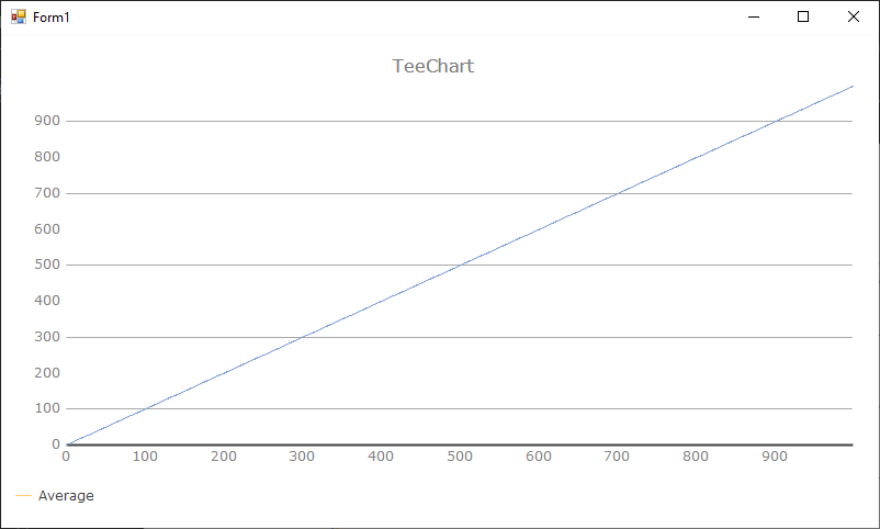

When importing a function, the data source is set to null, therefore no data is found. In the tchart version 4.2023.4.18 the importing of a function was working correctly as it was setting the data source to the correct series. Has this behavior changed? Also when importing the chart the legend does not come up correctly as seen by screenshot, it is aligned to the left. Once clicked inside thee chart area the legend moves to the bottom.

Any update on the legend not coming up properly. The legend comes up on the left and does not show all items correctly until zooming in or something.
