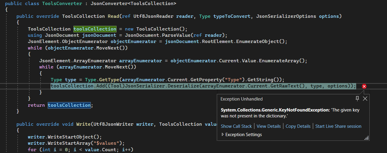

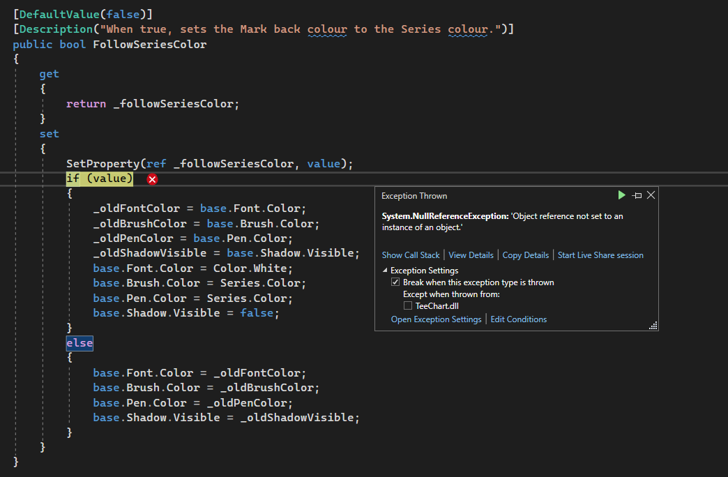

It seems to crash here. I have attached screenshots when running in debug mode where it crashes. I created a winforms application with these files in it. Let me know if you can reproduce it with this.

Post by Marc » Wed Nov 08, 2023 4:50 pm
Thanks you for the extra info. I can reproduce the error in a fresh project. My test project may be hanging on to a cached-package reference; I'm checking for differences and cause.
