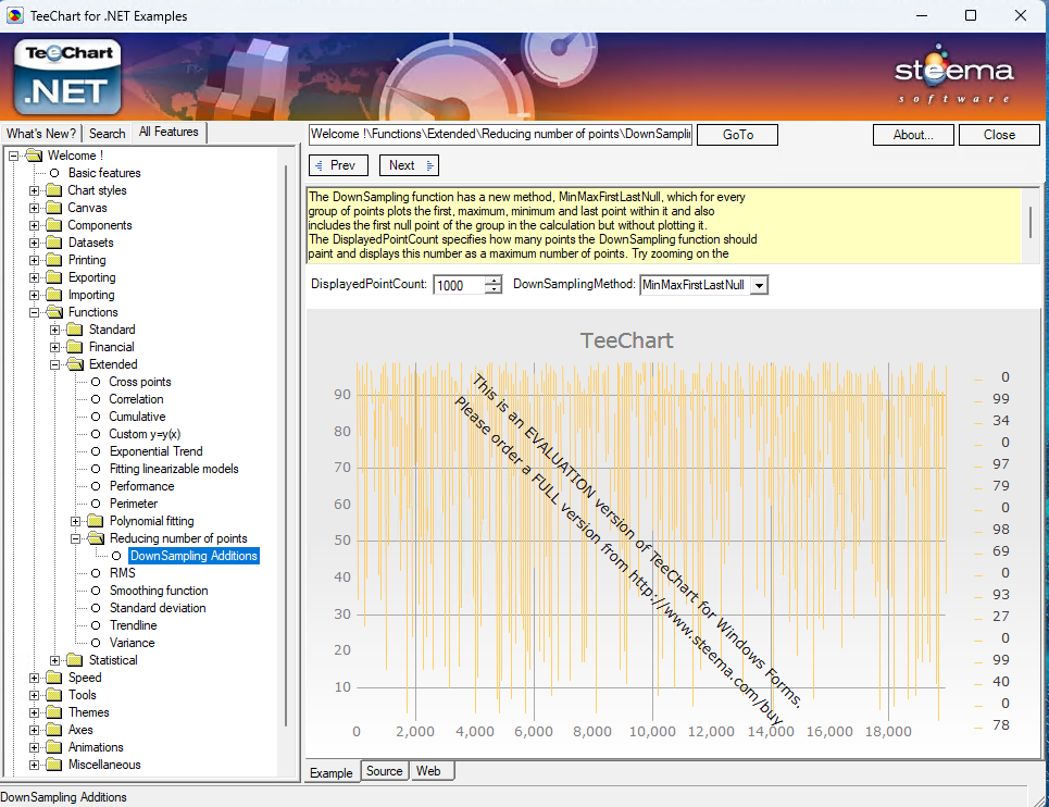

for that many points we recommend Downsampling—there's an example of this in the sample for net60 and the sample for net4.0:
Screenshot from 2023-07-28 11-28-47.png (247.09 KiB) Viewed 17036 times
