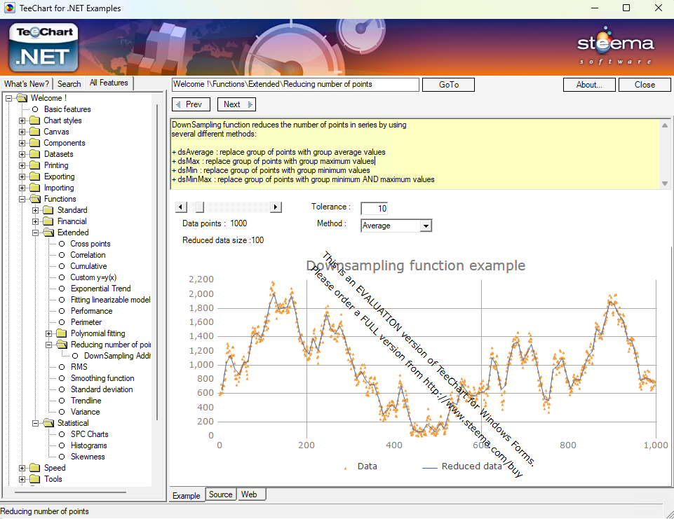

There's a useful sample you can run to see how to use the Downsampling function:
Screenshot from 2023-07-05 16-14-08.png (215.8 KiB) Viewed 23018 times
This sample is in our TeeChart-NET-Pro-Samples repo on GitHub, and the sample in question can be found:
  1. for net6.0 under NetDemoNET60
  2. for net40 under Feature Demo

How do you get the screen shot you posted ?
This is exactly the kind of help i am looking for.
I took the screen-shot having run the samples I mentioned in my last post. That is, clone (or download) the repo, navigate to one of the two folders I mentioned and then open the Visual Studio solution file (*.sln) within it.
