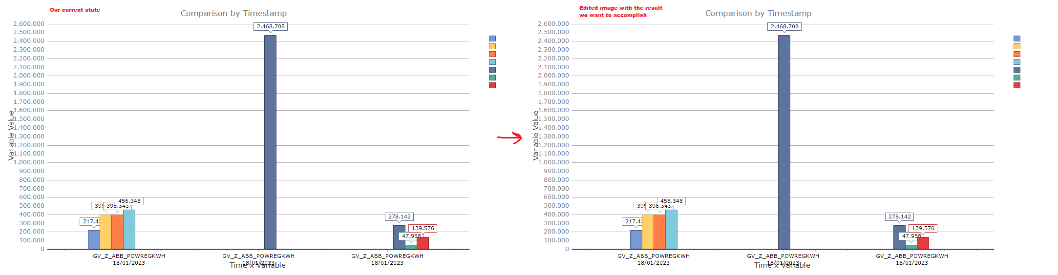

I am assigning each bar to its position, the problem i have is that the bars do not center to the axis (variable name+date), i know about a property called indexation, but i do not really know how to use it in order to center bars to the variable at the axis. Below you can see my current state and at the right, the one i would like to achieve.
Thank you.

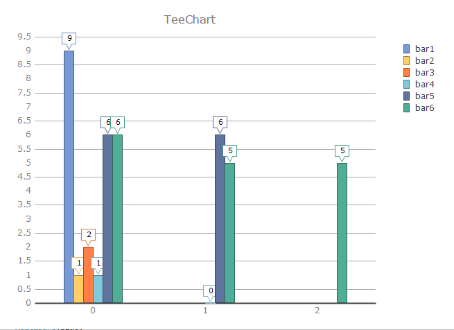

Just to confirm: when running this code:
            for (int i = 0; i < 6; i++)
                var bar = new Bar(tChart1.Chart);
                if(i <= 2)
                    bar.FillSampleValues(1);
                else if(i >= 2 && i <= 4 )
                    bar.FillSampleValues(2);
                else if (i >= 4 && i <= 6)
                    bar.FillSampleValues(3);
                bar.MultiBar = MultiBars.Side;
Which gives me:
Screenshot from 2023-06-22 18-14-44.png (14.12 KiB) Viewed 14410 times
You want the third bar6 bar with value '5' to be directly over the '2' of the X axis?
