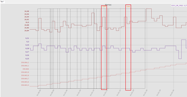

After upgrading my project from the 2016 version to the 2023 i am experiencing the following two problems:

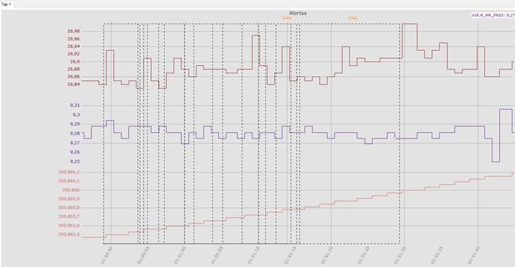

First, when i plot a lot of data the graphic starts to get a bit laggy you can see what happens when we try to Zoom. As well, the NearestPoint Event to the mouse starts to be a bit unresponsive. With the 2016 version this was not a problem:
The second problem that i have experienced with the 2023 version is that some line maks are not drawn, we have marked with red boxes where they should supposed to be:

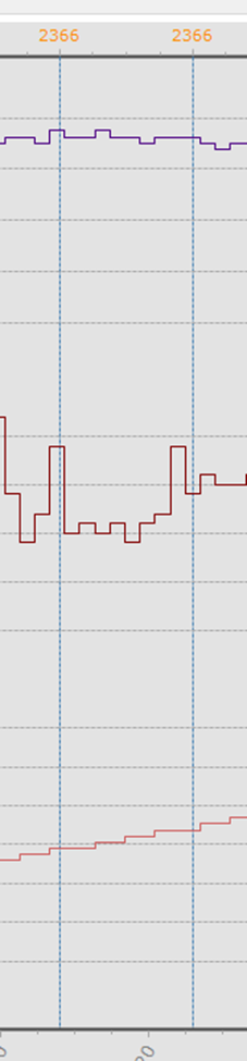

And using the 2016 version you can see what am i expecting in the red boxes above (the blue lines):
I've been updating our benchmark speed tests which you can try yourself by downloading our example repo—these are build using Windows Forms, one set for net6.0 and the other for net472 and net48. The results we get here are as follows:
If you would be so kind, we're going to need a Minimal, Reproducible Example to be able to reproduce this issue with precision at our end and try to fix it for you. We have a location on our website where you can upload a zip file with your project.
