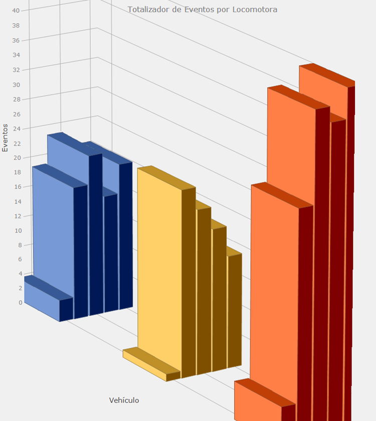

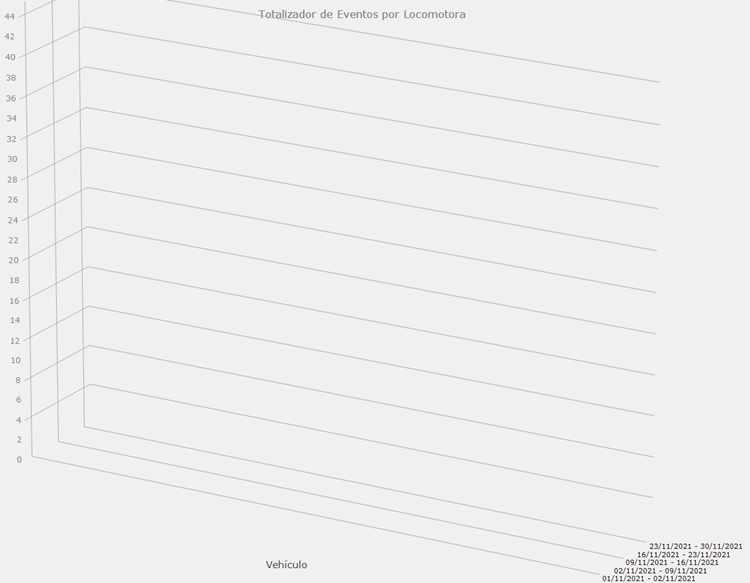

I have recently upgraded my project from the 2016 library to the latest 2023 one. The problem is that i am experiencing an issue with the 3D graphic bars. When i amply a slight rotation to the graphic, the bars disappear. This issue was not present with the 2016 version. I have attached two images with my initial state and when i apply some rotation.
Initial state:
After rotation:

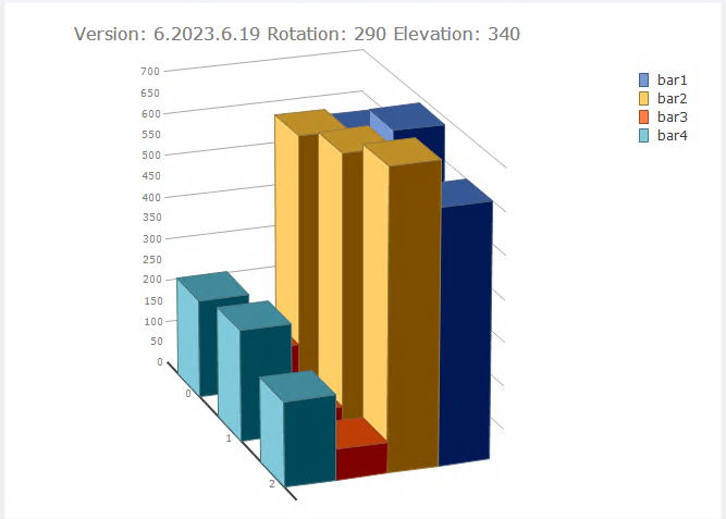

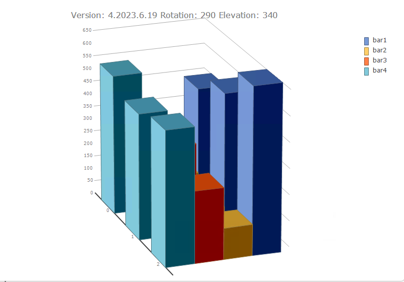

Against NuGet v.4.2023.06.19, I obtain this for the .NET Framework 4.0 assembly:
Screenshot from 2023-06-22 11-09-34.png (36.73 KiB) Viewed 12916 times
And this for the .NET 6.0 assemblies:
Screenshot from 2023-06-22 11-15-32.png (98.48 KiB) Viewed 12916 times
When I move the Chart around using the Rotate tool I am unable to find a position in which bars disappear. Could you please modify this code so I can reproduce your issue in one (or both) of the .NET runtimes?
