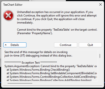

Attached is a very simple sample project that reproduces an exception when changing the datasource to "manual" under Series/Datasource in the options dialog.
Extract and open the solution in VS2022. Turn "on" exceptions by ticking on the "Common Language Runtime" in the exceptions docking window. Run it (it uses the latest TeeChart NuGet package) without debugger attached. Click the Options button, go to Series / Datasource and switch the drop-down to Manual.
I've tracked the issue down to the code using DataBindings.Add with a DataGridView instead of just assigning the Datasource property to the DataTable.

Image of unhandled exception

Hello Kris,
thank you for the bug report, as is standard procedure we can add these reports directly to our issue tracker, as I have done in this case with id=2615.
Re: Manual DataSource Causes Exception
Post by Christopher » Tue Jun 20, 2023 4:34 pm
Hello Kris,
this is now fixed, and the diff for you to fix the sourcecode, if you so wish, is this:
diff --git a/TeeChart.PCL.NET5/TeeChart.WinForm/Editors/Series/SeriesEditor.cs b/TeeChart.PCL.NET5/TeeChart.WinForm/Editors/Series/SeriesEditor.cs

Kris C
Posts: 59
Joined: Fri Jan 13, 2023 12:00 am
Post by Kris C » Tue Jun 20, 2023 5:22 pm
Thank you, Christopher, for the quick turnaround. I'll make our change consistent with yours.
