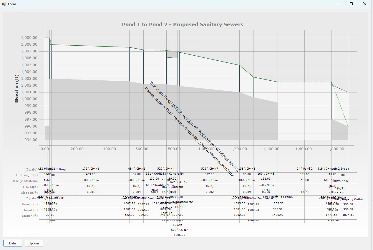

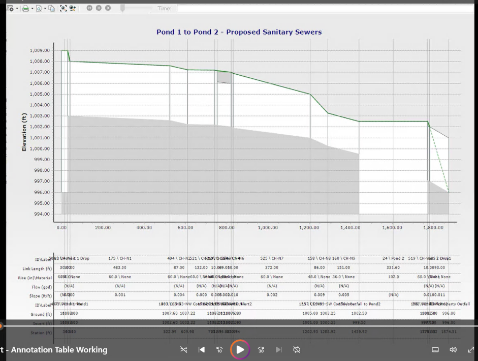

Thank you. Yes; I notice that the Custom Axes labels look quite different to start with:
Screenshot from 2023-05-15 13-34-15_2.png (475.24 KiB) Viewed 65884 times
And:
Screenshot from 2023-05-15 13-42-35.png (121.5 KiB) Viewed 65884 times
Can you explain why the labels are lined up horizontally in the top version, but are not in the bottom one? This might be an important difference.

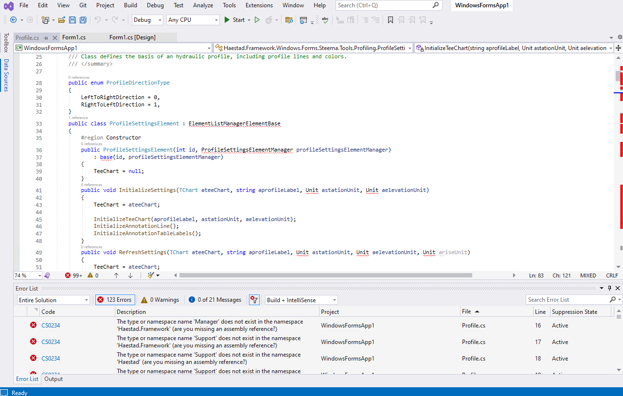

When I try to compile your Profile.cs, I obtain:
Screenshot from 2023-05-16 17-14-57.png (134.93 KiB) Viewed 65853 times
We usually ask for a minimal, reproducible example to speed up our responses to our clients. Is there going to be any way you can get one to us please? If not, maybe you could suggest the best way for us to try and get something up and running at our end.
