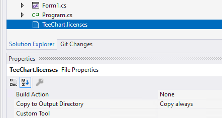

Running this in a WinExe project in framework net6.0-windows with the TeeChart.licenses set to Copy always:
Screenshot from 2023-03-17 09-45-20.png (11.2 KiB) Viewed 63855 times
Produces a Chart without a watermark. So we now have to discover what is different about your set up. Which NuGet package are you using? Is your TeeChart.licenses set to 'Copy always' (you could try this in a simple test project to be sure)? Do you have a valid license for TeeChart for .NET 6.0? You can check this latter question by visiting:

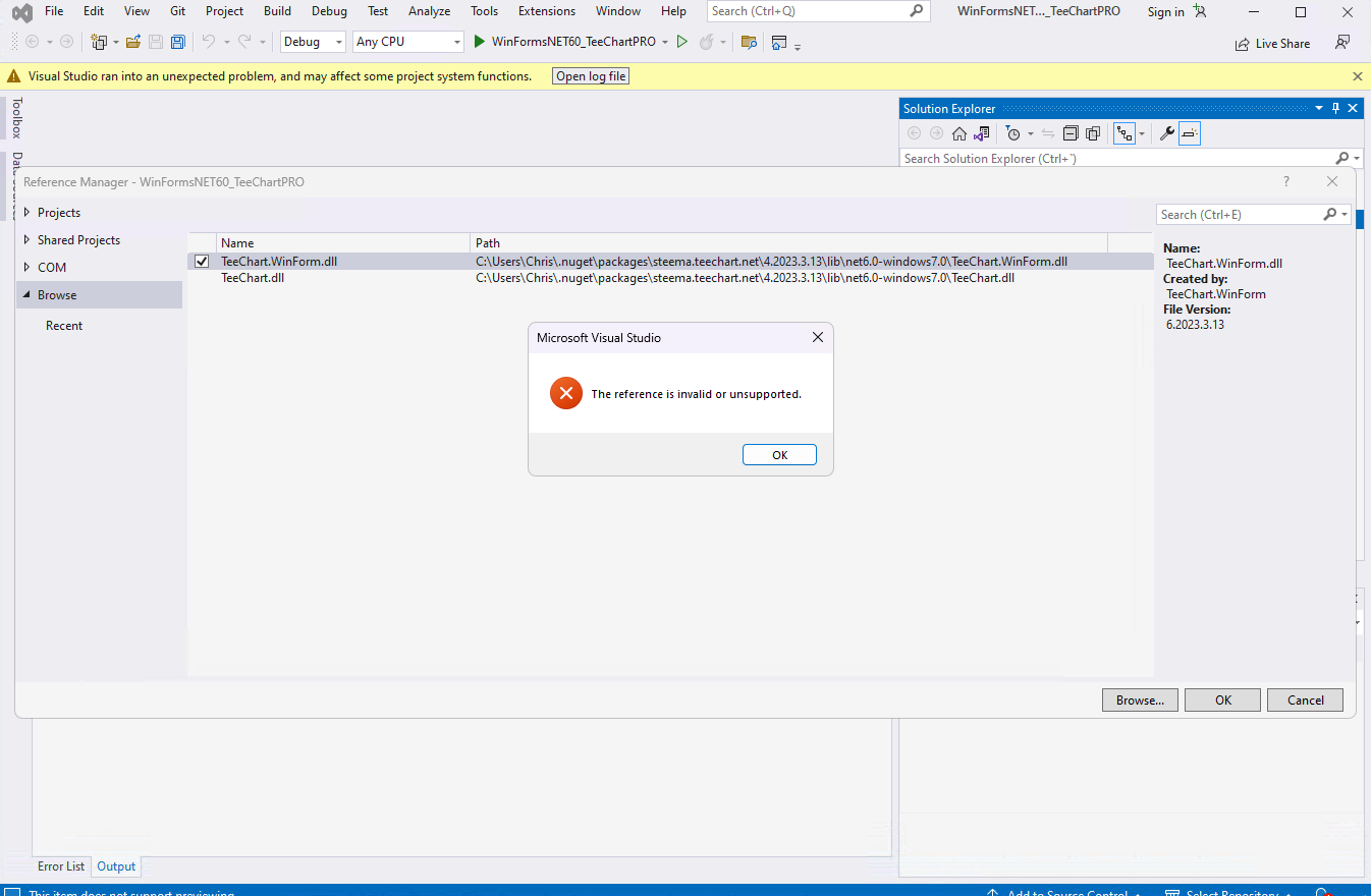

we really need to be able to reproduce this issue here to see if we can fix it. If I remove the NuGet package from my test project and try to add in the TeeChart.WinForm.dll directly, Visual Studio v.17.5.2 gives me an error message:
Screenshot from 2023-03-20 11-24-16.png (87.76 KiB) Viewed 63828 times
The log tells me:
20/03/2023 11:23:44
Recoverable
Microsoft.Build.Exceptions.BuildAbortedException: MSB4188: Build was canceled.
I'm not sure what's going on here, but it does mean I cannot try to reproduce your issue by running a Windows Form .NET 6.0 project without referencing the NuGet file.
