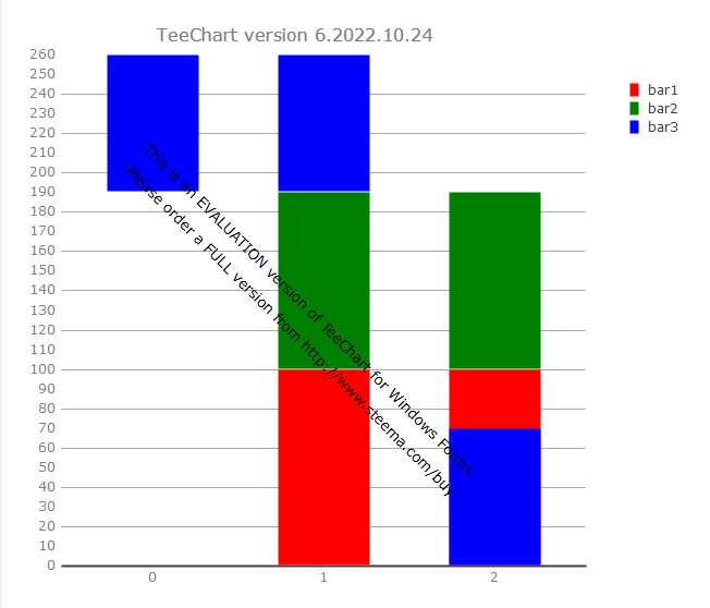

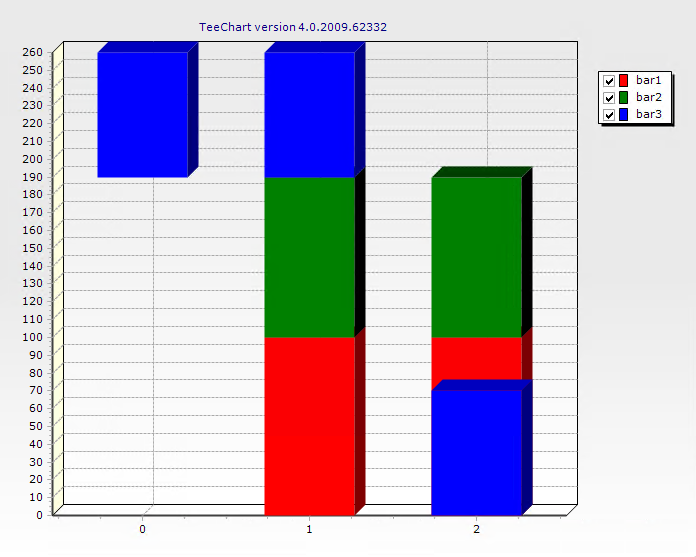

This hasn't changed between the thirteen year-old version:
Screenshot from 2022-10-26 17-04-23.png (90.74 KiB) Viewed 6601 times
and the most recent one:
Screenshot from 2022-10-26 17-06-53.png (26.88 KiB) Viewed 6601 times

All right. I see.
I think the chart problem will be solved by adding the 0th value.
