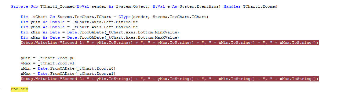

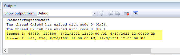

Hi Steema,
When I zoom into a chart I'd like to get the zoomed MinX , MinY, MaxX, and MaxY values and thought it would be in the Zoomed event but am finding it challenging to figure this out. Please see attached screenshots. I'm doing something wrong.
Thanks as always!

using the following code works fine. Could you please check?
        Steema.TeeChart.TChart _chart = new Steema.TeeChart.TChart();
            Controls.Add(_chart);
            var line = new Steema.TeeChart.Styles.Line(_chart.Chart);
            line.XValues.DateTime = true;
            line.FillSampleValues();
            _chart.Axes.Bottom.Labels.Angle = 90;
            _chart.Zoomed += _chart_Zoomed;
        private void _chart_Zoomed(object? sender, EventArgs e)
            MessageBox.Show("Min YVal:" + _chart.Axes.Left.Minimum.ToString() +
                " | Max YVal:" + _chart.Axes.Left.Maximum.ToString());
            MessageBox.Show("Min XVal:" + DateTime.FromOADate(_chart.Axes.Bottom.Minimum).ToString() +
                " | Max XVal:" + DateTime.FromOADate(_chart.Axes.Bottom.Maximum).ToString());
