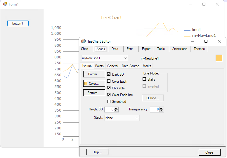

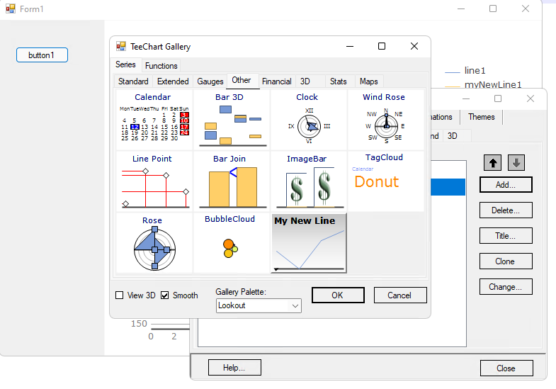

you can register your overridden series so it appears in the Chart Editor, e.g.
      Utils.RegisterSeries(typeof(MyLine), typeof(MyLineEditor), 7 /*Other*/, 1);
      var line = new Line(tChart1.Chart);
      line.FillSampleValues();
      var myline = new MyLine(tChart1.Chart);
      myline.FillSampleValues();
    private void button1_Click(object sender, System.EventArgs e)
      tChart1.ShowEditor();
  public class MyLine : Line
    public MyLine(Chart c) : base(c)
    public MyLine() : this(null)
    public override string Description => "My New Line";
  public class MyLineEditor : Steema.TeeChart.Editors.Series.CustomSeries
     public MyLineEditor(Series series, Control parent) : base(series, parent)
     public MyLineEditor(Series series) : base(series)
     public MyLineEditor() : base()
Which gives us:
Screenshot from 2022-04-12 14-18-28.png (41 KiB) Viewed 7255 times
Screenshot from 2022-04-12 14-18-48.png (53.07 KiB) Viewed 7255 times
