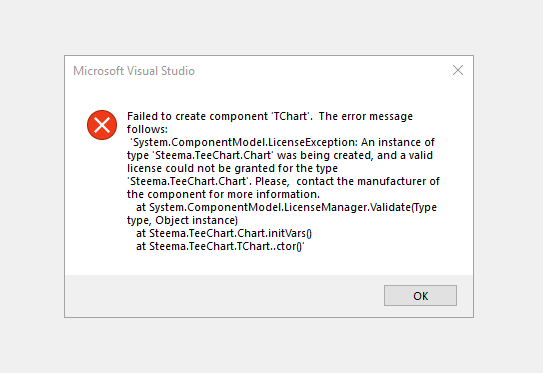

I am really struggling to resolve an error.
I am installing via NuGet as soon as I drag the TChart onto a winForm I get this error.
This is regardless of whether I have a license file in the project or not?
I have tried removing the nuget, cleaning, deleting bin and obj folder.
I am using VS2022 and this is a winforms project
Ive spent far too long on this and you are my final resort.
Many thanks.
Many thanks.

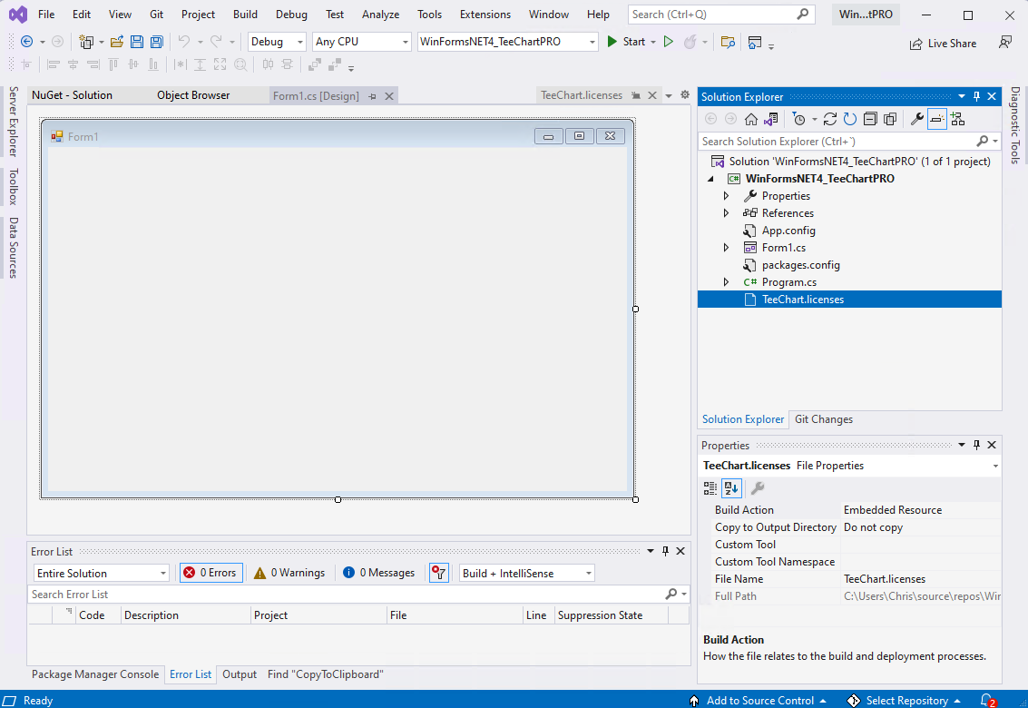

Re: Failed to create component TChart
We would like to know what happens when you create a new WinForms project in VS2022 with your TeeChart.licenses as an Embedded Resource, so your project looks like this: The code in the Form1.cs should look like this:
When you run this form, you should not see a watermark on your Chart.
using Steema.TeeChart;
using System.Windows.Forms;
namespace WinFormsNET4_TeeChartPRO
private readonly TChart tChart = new TChart();
Controls.Add(tChart);

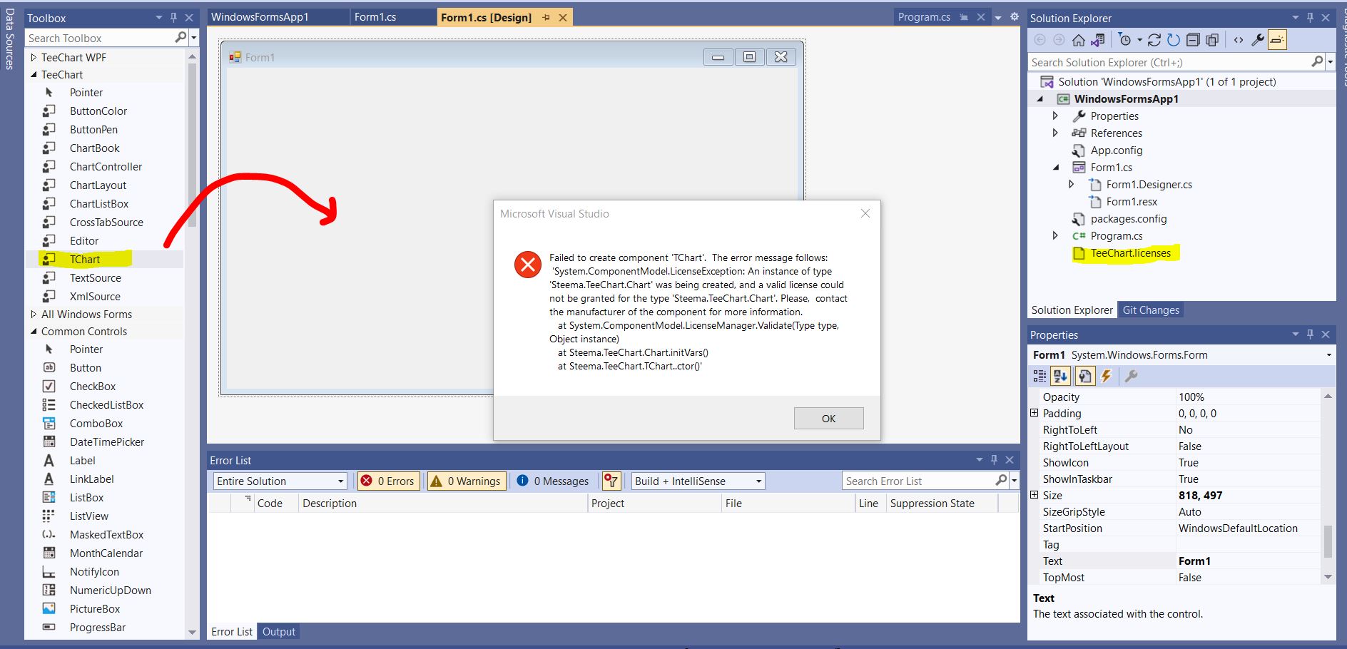

Hi Christopher!
Thanks for getting back!
Your suggestion using C# and adding the TChart element in code is working fine. The program starts and I see TChart on the form without watermark.
However, when using the VS Toolbox to draw a TChart Element on the form I get the error message.
I also get the design time error in VB.NET when trying to draw a TChart element on a form.
I will now try to add the element by code in VB.NET to see if that works.
Holger
Holger

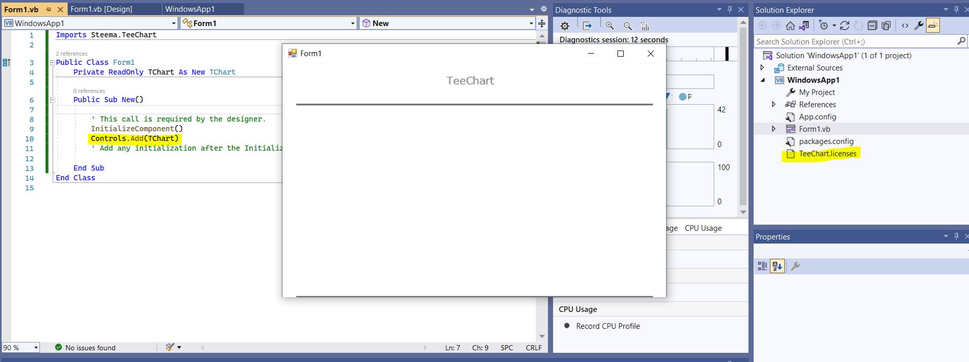

Ok, I have validated that VB.NET is also working at runtime without watermark when adding TChart in code.
The problem then seems to be related to the Toolbox Controls when adding a TChart by drawing on a form.
I hope this can be resolved quickly.
I have a project with ~15 TChart graphs added via Toolbox and this project currently does not run.
Holger
Holger

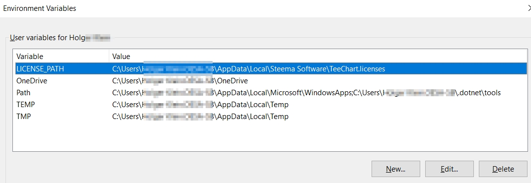

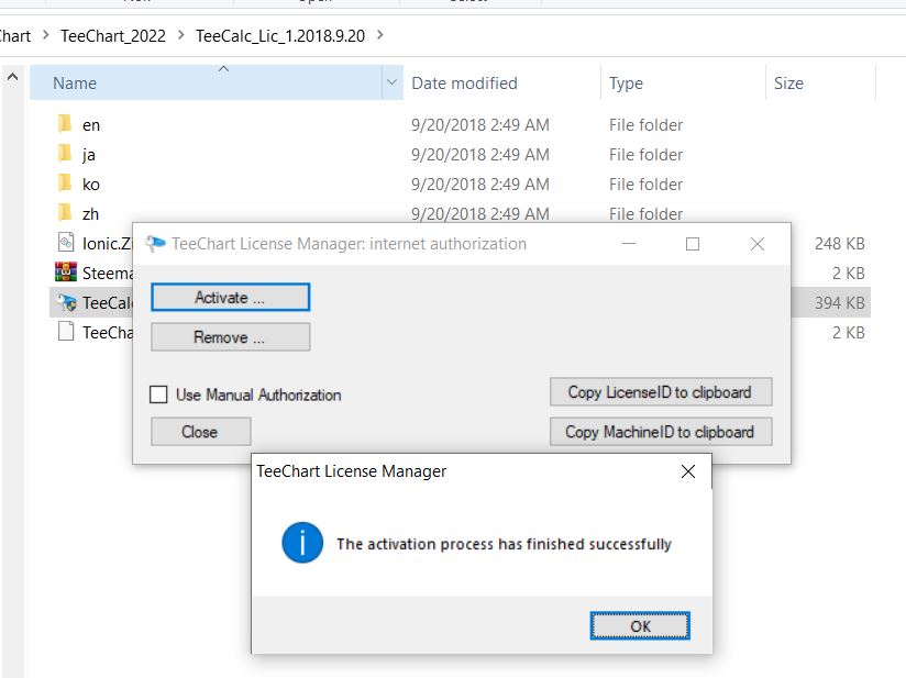

Hi Christopher!
I have run TeeCalc_Lic.exe 3x times now and it always showed correct activation.
How else would I have the TeeChart.licenses file that I add to the project?
I also checked the Windows10 LICENSE_PATH variable that is being added in the system environment variables.
Holger
Holger
Hi Christopher,
To your #1.... Ok. I didn't think about that but unfortunately true.
I tried this yesterday already and have rebooted the machine 2 time already in the meantime.
Is the system environment variable correct as shown in the screenshot?
Holger
Holger
- TChart_Error_#4.JPG (128.19 KiB) Viewed 16934 times
- Guru
- Posts: 1603
Hello Holger,
that looks fine - it's more likely to be an issue with the Registry and its reading.
