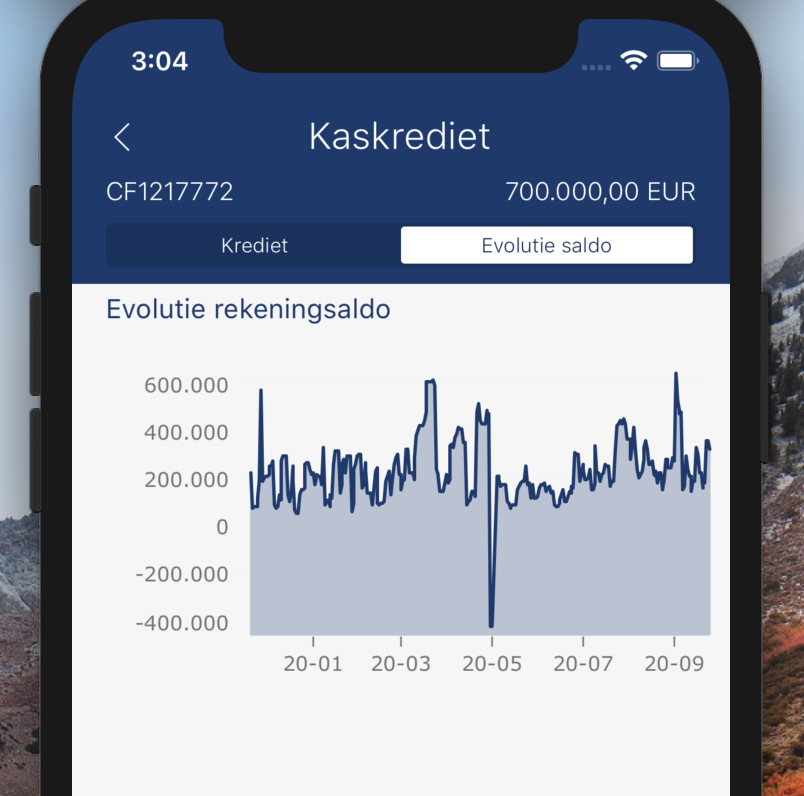

We use the AreaLineChart in our Xamarin Forms application.
But no matter what we set the WidthRequest to, there is always more left margin white space than on the right side.
We set the control to Center.
Cfr screenshot.
How can we get equal margins?

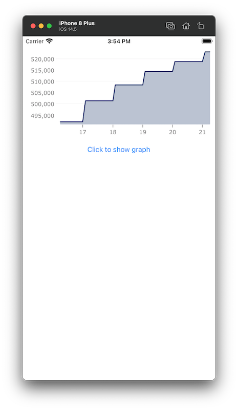

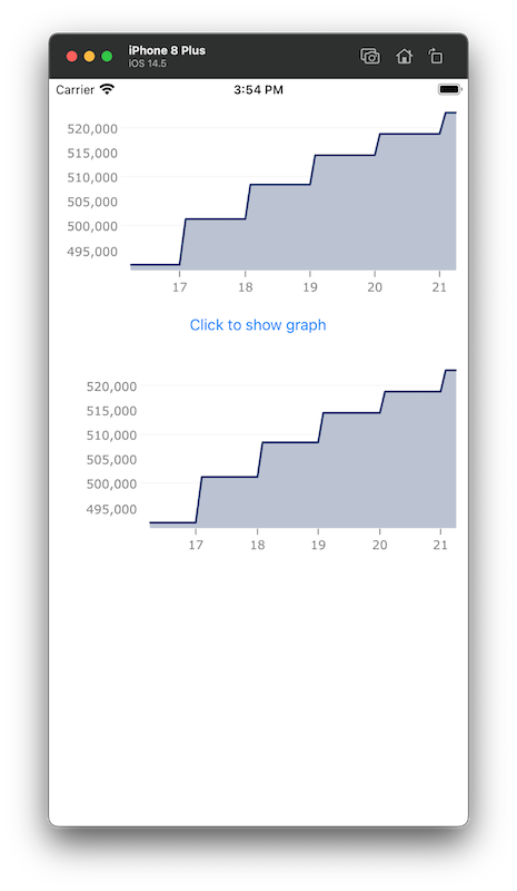

Here I load the same graph twice on the page, the first one is just like your sample the second one has a bool bound to IsVisible and will become visible with the button click.
This will render it smaller! Cfr screenshots.
Do you still need extra info on code? I can supply the example if needed.

Re: Left margin AreaLineChart
ok, it's very strange problem. Let me check here and back to you. If I need code you use will ask.
yes, you're correct, I'm able to reproduce the problem here.
For the moment still not found what's the cause of this. We will review more carefully in order to find a solution.
In meantime, would be an option to you to set invisible via code instead of doing it via binding ?
