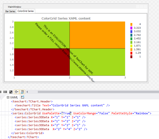

just to let you know we've released a new NuGet in which the ColorGrid series is present in the TeeChart.Xaml.WPF assembly - you can see an example of it working in this example:
Screenshot from 2021-04-22 13-09-26.png (47.58 KiB) Viewed 49399 times

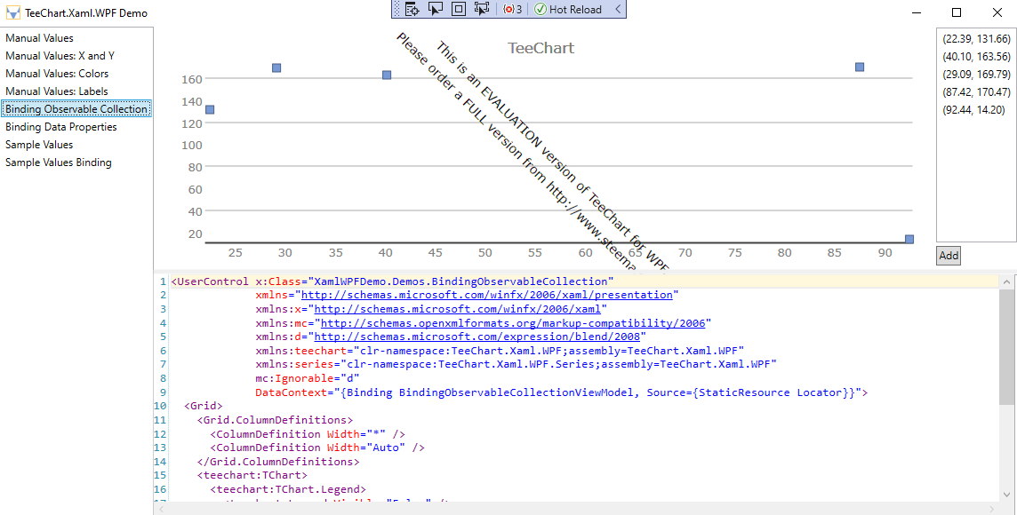

There are a couple of Binding examples already in the examples, specifically those in this example here:
Screenshot from 2021-04-26 17-16-31.png (97.19 KiB) Viewed 49294 times
You should be able to adapt these techniques to the ColorGrid - any problems do please let us know.

Which of the two examples are you trying to follow, BindingDataProperties.xaml or BindingObservableCollection.xaml?
jfrtx
Posts: 16
Joined: Wed Jul 01, 2020 12:00 am
Re: WPF ColorGrid DataBinding
Post by jfrtx » Mon Apr 26, 2021 4:04 pm

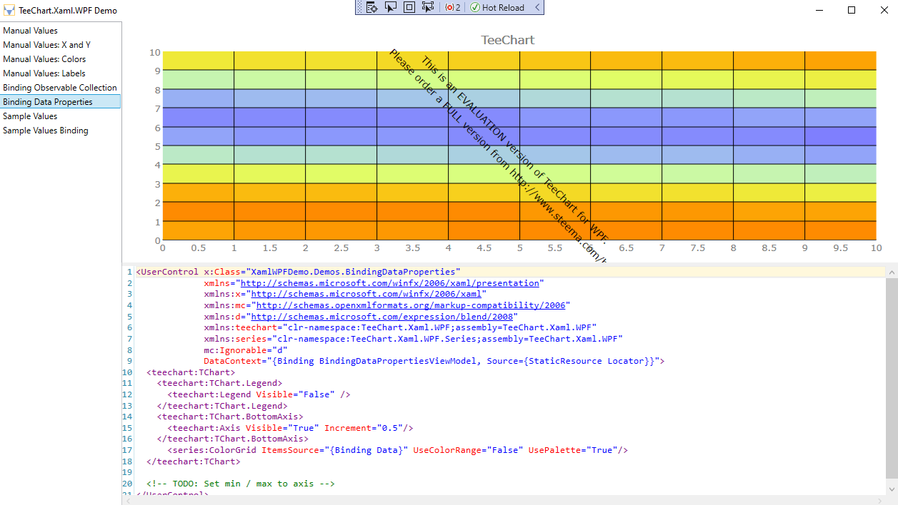

Okay, I've made a change at the GitHub example here which you will now be able to run:
Screenshot from 2021-04-27 10-51-00.png (108.94 KiB) Viewed 49183 times

I changed your BindingDataPropertiesViewModel constructor slightly to show a problem I am seeing. I expect to see a ColorGrid where both axis range from (-1 to 1). Instead I see something that is partially displayed in the upper right half. In this example dx=0.2 and dz=0.1. Therefore, the axis ideally should be x=-1,-0.8,-0.6,...,0.8,1.0 and z=-1,-0.9,-0.8,..., 0.9, 1.0. However, due to numerical precision, the axis appears to be irregular which is causing problems for ColorGrid.

Does this code work for you at runtime, that is, without use of the TeeChart.Xaml.WPF assembly?

I am not sure I understand your question. Are you asking if the code snippet I supplied for a change in the constructor compiles and runs?
Yes, I was able to compile and run the changes in the example project that you created.
