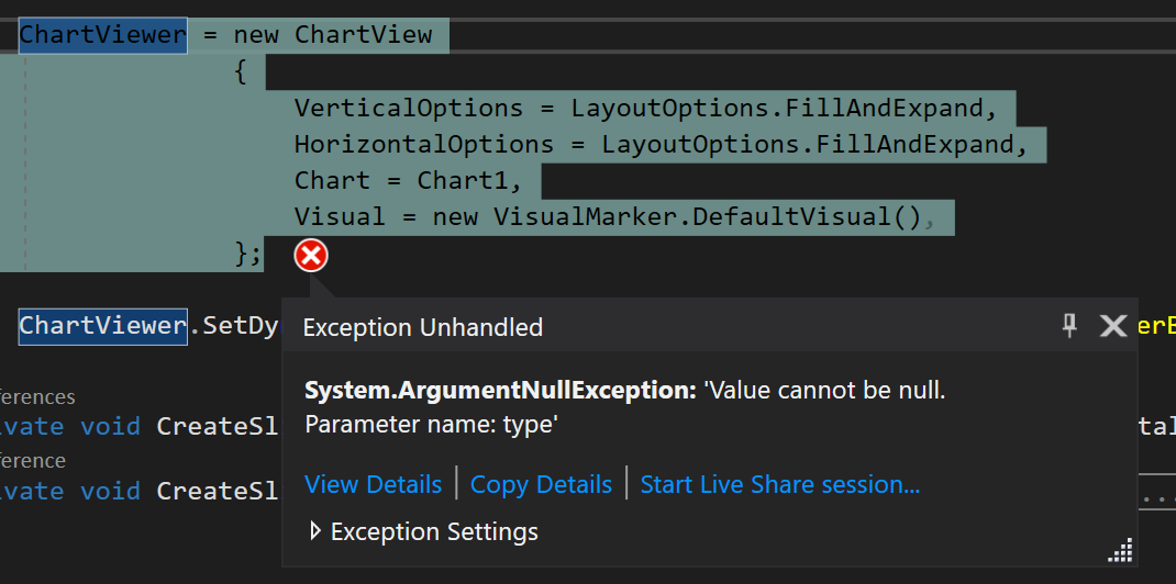

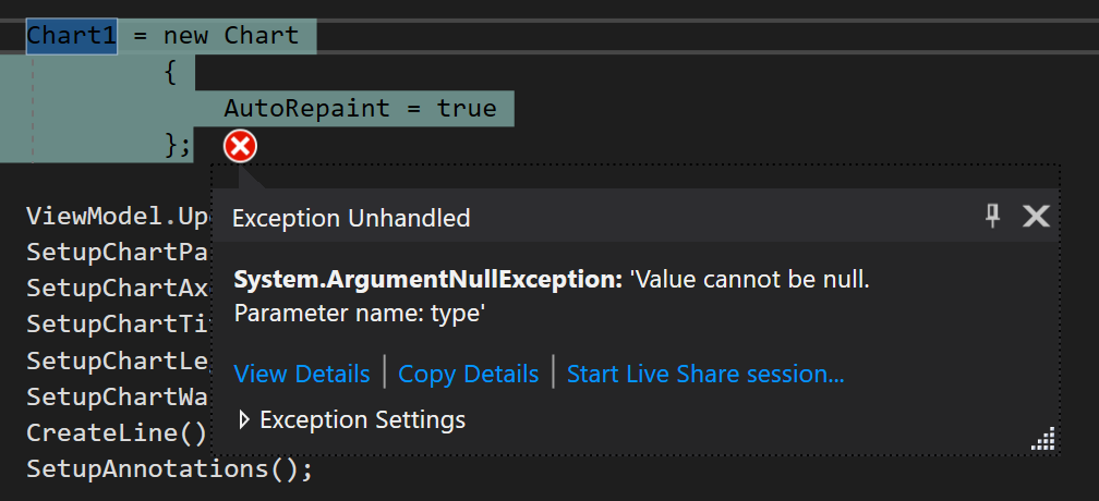

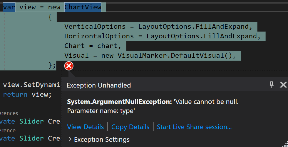

With Xamarin.Forms Version 5.0.0.1874, Version 4.8.0.1821, Version 4.8.0.1687 and Version 4.8.0.1560, graphs break on both Android and iOS. it displays if you catch the exceptions but does not render correctly: popup annotations are broken and don't show, pinch and zoom is gone, etc.
I have not tested versions prior to Version 4.8.0.1560.

Re: System.ArgumentNullException Value cannot be null. Parameter name: type
it seems that is working fine here. Do you have a simple example to reproduce it ?
Anyway, just tell to you, that we're going to upload a new nuget version package before the end of this week (compiled with the latest Xamarin.Forms version).

Yes, the exception seems to be related with Xamarin.Forms v5. Not sure if it also happens to you with older Xamarin.Forms version.
Also, the previous exceptions still over on page creation.
