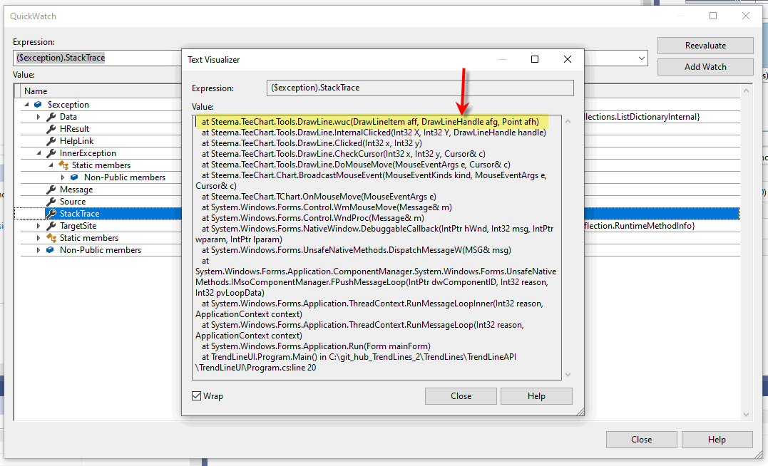

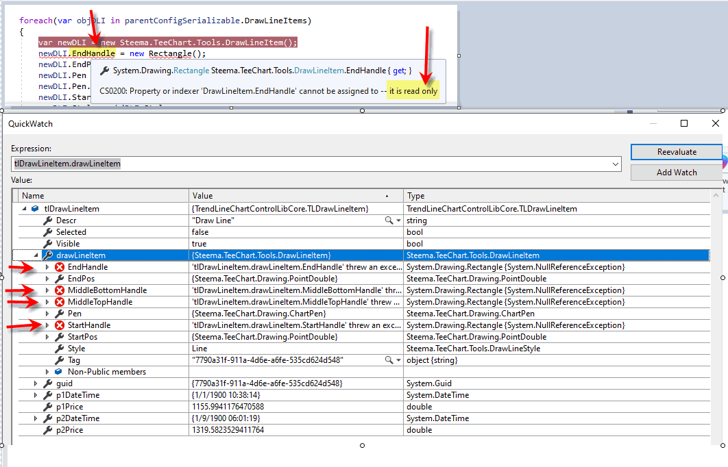

I'm adding DrawLineItems to the Lines collection and that's fine --
Until the chart tries to refresh and throws an exception because all the "Handles" fields such as EndHandle, MidlleBottomHandle, MiddleTopHandle, and Starthandle are Null so a NullReferenceException is thrown.
My question is how to either populate the Handle values or avoid the exception when programmatically adding DrawLineItems to a .Net TeeChart?

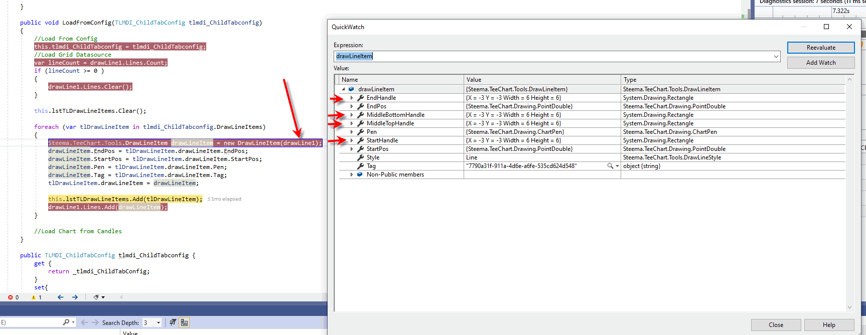

My populate code:
Null "Handle's" in DrawLineItems

I think the reason is that you are using the parameterless constructor of DrawLineItem, which means that EndHandle will throw an error (following code is from the sourcecode):
        public Rectangle EndHandle
            get
                return RectangleFromPoint(tool.AxisPoint(EndPos));
It will throw an error because the tool variable is null - this is the parameter you can pass in the other constructor of DrawLineItem, e.g.
        private void InitializeChart(TChart chart)
            chart.Series.Add(typeof(Line)).FillSampleValues();
            var drawLine = new DrawLine(chart.Chart);
            var item = new DrawLineItem(drawLine); //<-- pass in the 'tool' here
            item.Pen.Width = 3;
            item.Pen.Color = Color.Red;
            item.StartPos = new PointDouble(1, 1);
            item.EndPos = new PointDouble(3, chart.Series[0].YValues.Maximum);
            drawLine.Lines.Add(item);
