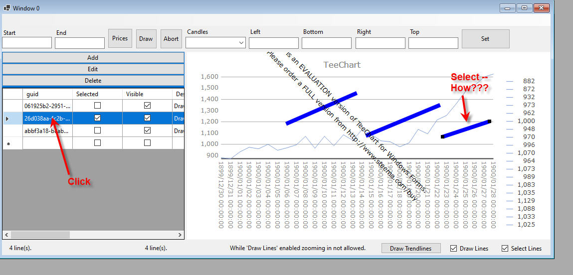

Hi All -- Love the DrawLines class never used it before.
I have a list on the screen where I have a list of DrawLineItems on chart.
I want to be able to click on a line item in my list and have that line become "selected" on the chart -- as if I clicked on the line itself.
Is there some way to do that programmatically?

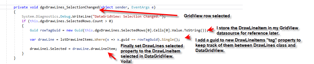

Figured it out --
Here's the code --
