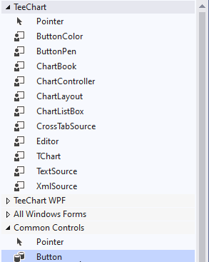

Hello.
In your StandardSeriesDemo sample project Steema.TeeChart.NET nuget package is added to project via old-style Packages.config format.
In that case TeeChart controls are automatically populated to VS Toolbox and are correctly added to form after drag-and-drop.
But if I choose new-style PackageReference in project file format TeeChart controls are NOT populated to VS Toolbox. A still can add the manually from TeeChart.dll (but all controls have different icons), but when I drag-and-drop TChart control on my form - nothing happends (no control is added to a form).

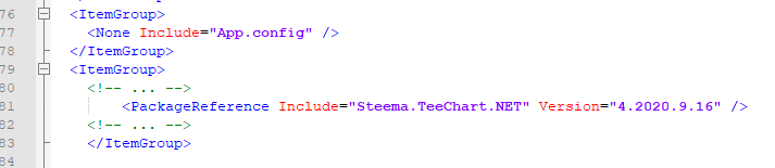

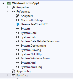

Don't know what is wrong with my VS installation (again?) but looks like I've found a workaround for me: after adding Steema.TeeChart.NET nuget via PackageReference .csproj file is not altered for some reason (PackageReference xml-tag is not added). But if after that I simply create for example an instance of TChart class (and add apropriate using above) - PackageReference xml-tag is instantly added to .csproj and TeeChart controls are not populated to VS Toolbox.
