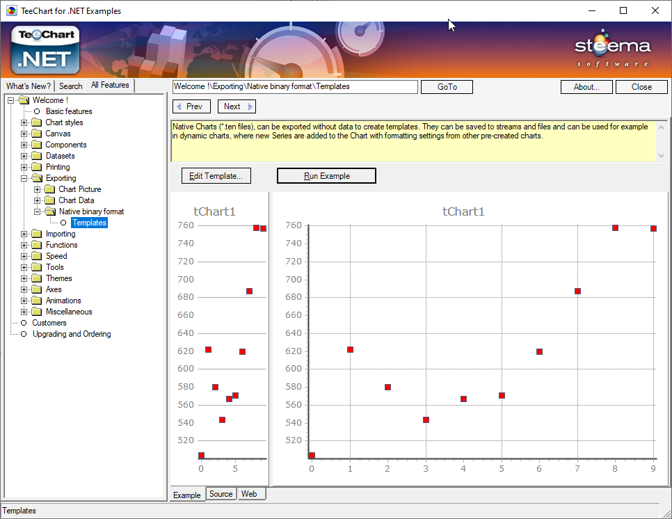

Re: Problems with Copy-Paste the whole chart.
Posted: Thu Nov 05, 2020 9:32 am
by Christopher
bairog wrote:
Thu Nov 05, 2020 6:38 am
Any updates on this? It's a real pain to create similar complex charts from scratch without be able to simply copy them..
You don't have to create them from scratch, as I mentioned, you can use the TeeChart native template files. To make it clear, please find a short screenshot gif I made to show you what I mean:
