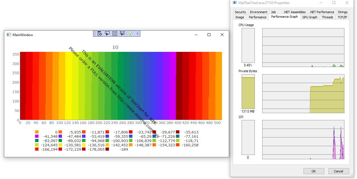

we have a Memory Leak in Custom3DGrid.
Each access will let the memory grow.
Is there a knwon issue with Custom3DGrid?

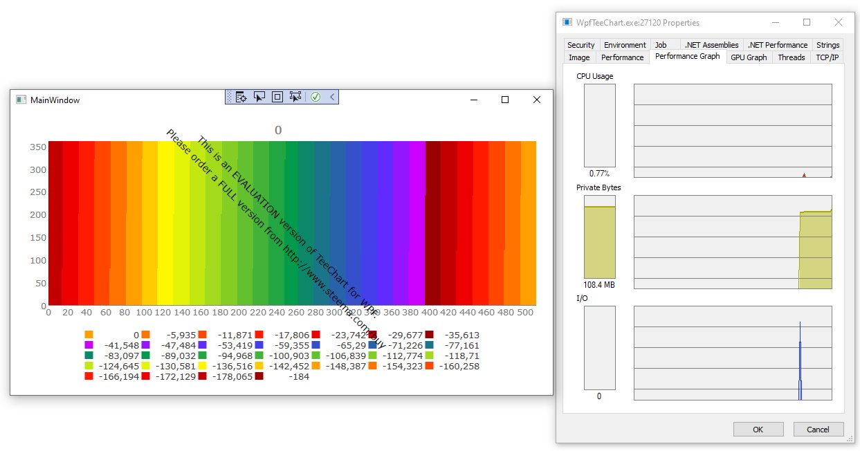

Here you will find a sample project: https://hcckpm-my.sharepoint.com/:u:/g/ ... w?e=3Y6gGB
After each click the memory usage will grow. It will fall down after a few clicks but not to the starting point.
In the sample we use the ColorGrid.
We also tested the same behavior on a second system. That's the reason why it is not registered.
We also used the latest nuget downloadable version from September.

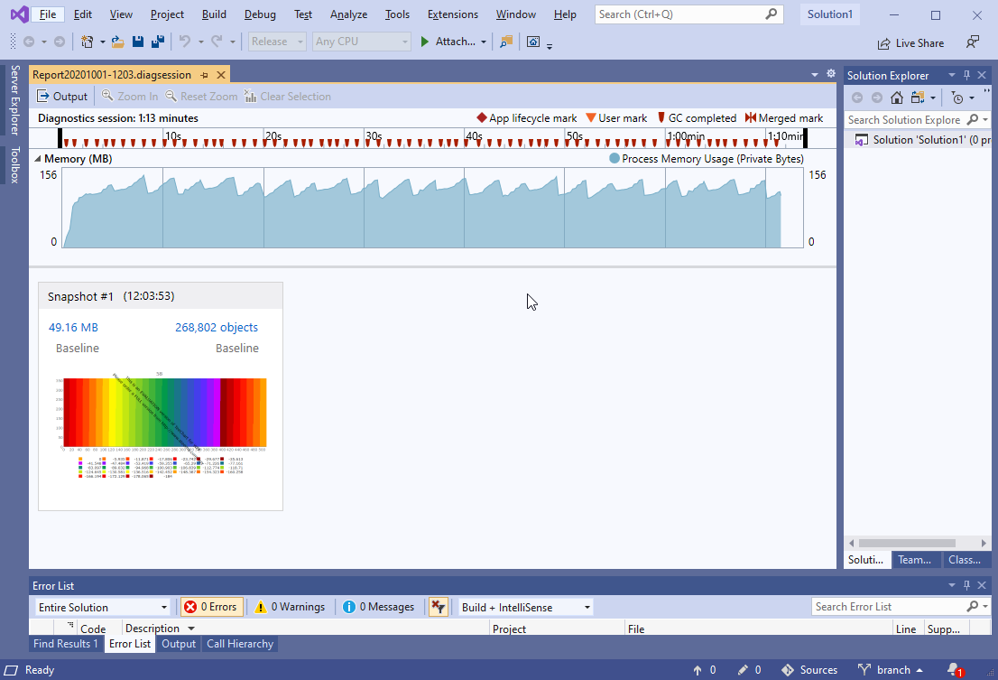

I've modified slightly your project to use a timer (which fires twice a second) instead of manually using a mouse:

I then ran this code in a Memory Usage diagnostic session as detailed here using the latest publicly available version of Visual Studio 2019. I've uploaded the results here in the form of a *.diagsession file which you can open in Visual Studio 2019. The results look like this:
As you can see, this specific diagnostic session has failed to detect any kind of memory leak in the code.
