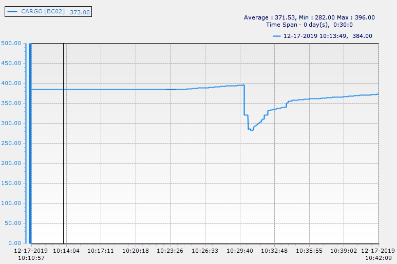

How to draw multiple line without adding series?
Post by goodsj » Tue Dec 17, 2019 1:48 am
For example, I have a sales chart by item with teechart.
I want to add break-even point line on 450.
How can I implement it? I think it would be good if you give me a sample
Thank you.

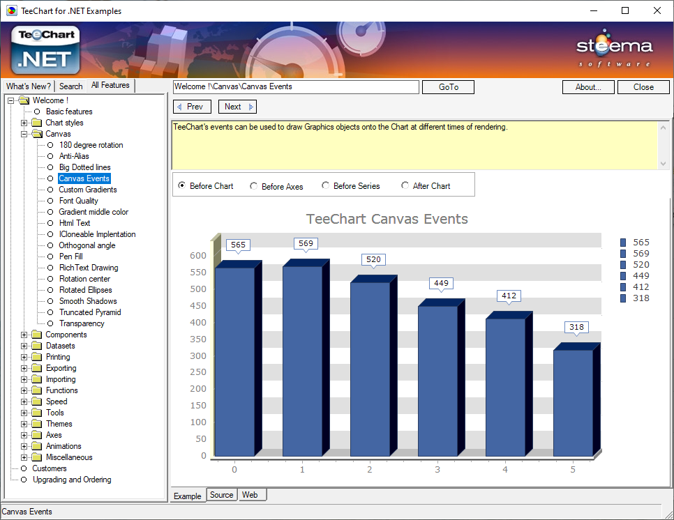

Of course - you can find the sample I refer to below in the TeeChart for .NET C# Windows Forms examples repo under the 'Feature Demo' folder. The sample shows TeeChart's canvas events which allow you to draw lines, shapes, text and images at any point of the chart at different times of its painting routine:
