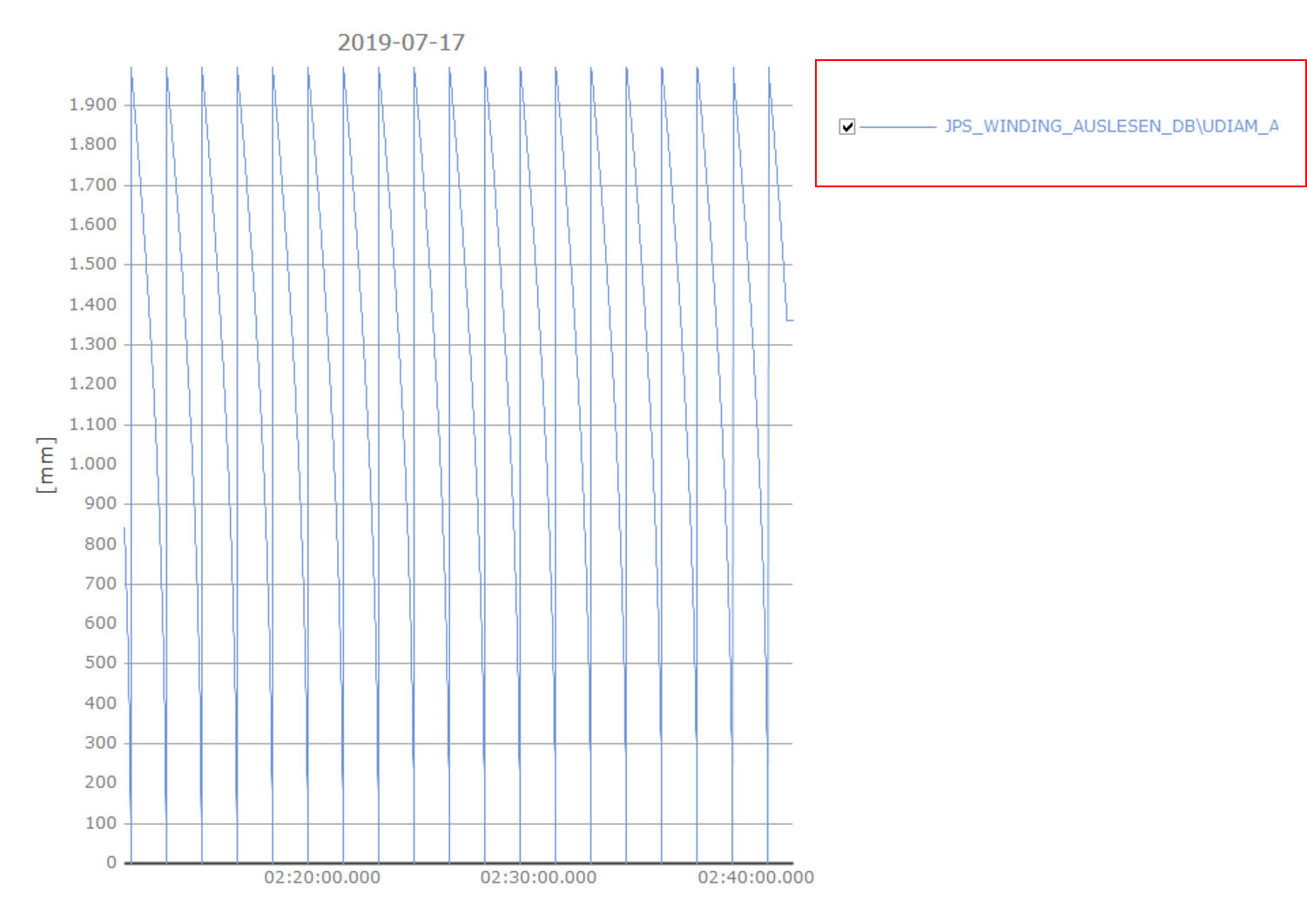

Hi all,
is it possible to set an individual text at the legend in the chart?
By now I just can chose the Series Name, but that is very long and so it take too much place in the chart.
Thanks in advance!
Best regards,
Florian

Post by bairog » Fri Jul 26, 2019 9:56 am
Hello.
I'm not from Steema team but looks like I know what to do :) - handle GetLegendText event, something like that:
private void tChart1_GetLegendText(object sender, GetLegendTextEventArgs e)
     //some checks (e. g. series index) if you need it
     if ((e.LegendStyle == LegendStyles.Series) && (e.Index == 0))
          //replace "-" with "" (or do whatever you like with legend text)
          e.Text = e.Text.Replace("-", "");
Good luck.
