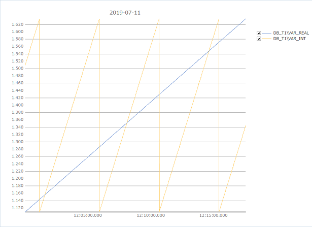

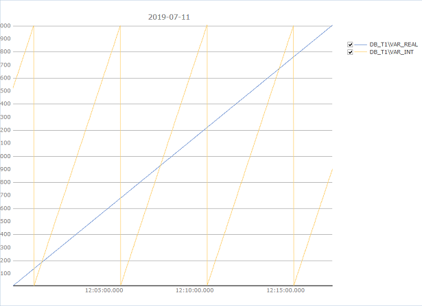

Hello Steema Support,
I've got an problem that I don't know how to solve.
Every Line in my Chart got an own Custom Y-Axis, but the first one uses the main Y-Axis.
I implemented a Function that hide or fade in the selected Axis.
But when a Custom Y-Axis is faded in, it doesn't get the same position like the main Axis.
So is there an option to set the same Axis-Position for the Custom Axis as for the main Axis?
Thank you for your help!!
Best regards,
Florian
Custom-Axis is too far left

Hello Florian,
You will need to specify a value for the LeftMargin of the Panel class to shift the Custom Axis across, e.g.
            var line = new Line(tChart1.Chart);
            line.FillSampleValues();
        bool _flag = false;
        Axis _custom = null;
        void SetCustom()
            _flag = !_flag;
            if (_flag)
                tChart1[0].CustomVertAxis = _custom;
                tChart1.Panel.MarginLeft = 7;
                tChart1[0].CustomVertAxis = null;
                tChart1.Panel.MarginLeft = 3;
            _custom = new Axis(tChart1.Chart);
            tChart1.Axes.Custom.Add(_custom);
            SetCustom();
