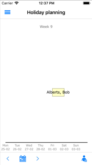

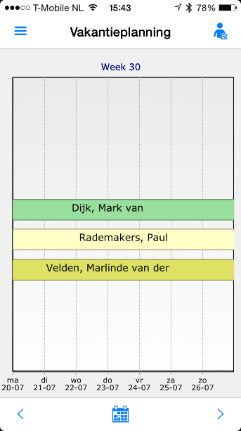

In the 2015 version our gantt chart it looked like this:
Using the 2018 TeeChart build it looks like this:
While the marks, bottom axis looks mostly the same and works fine, the borders and grid lines are missing.

However, I cannot seem to restore the black border around the chart. I've tried the Wall properties, the Panel.BorderPen properties etc. but to no avail.
Is there any way to re-create such a border in v2018?

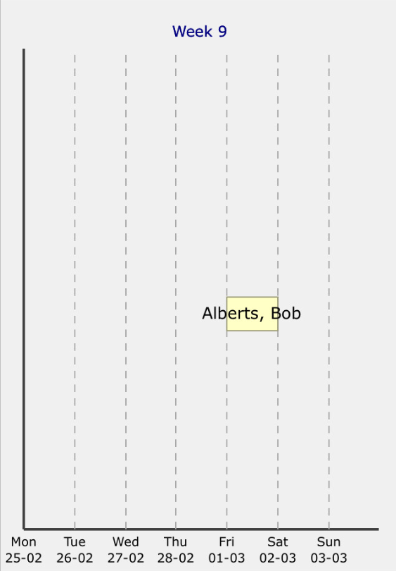

Thank you very much for the response. While this did revert the style the right and top borders still seem to be missing.
Changing the wall/border settings on the chart doesn't seem to make them appear or change.
What could be the cause of this?
