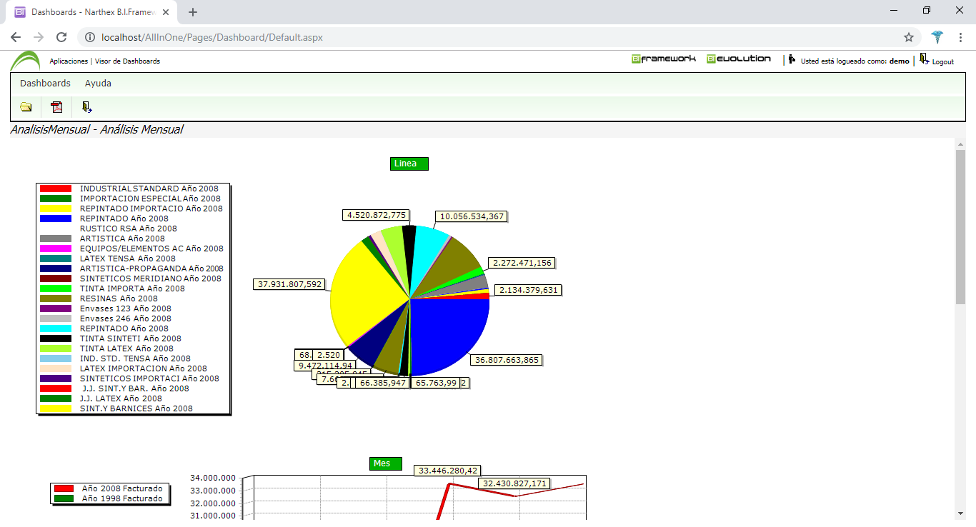

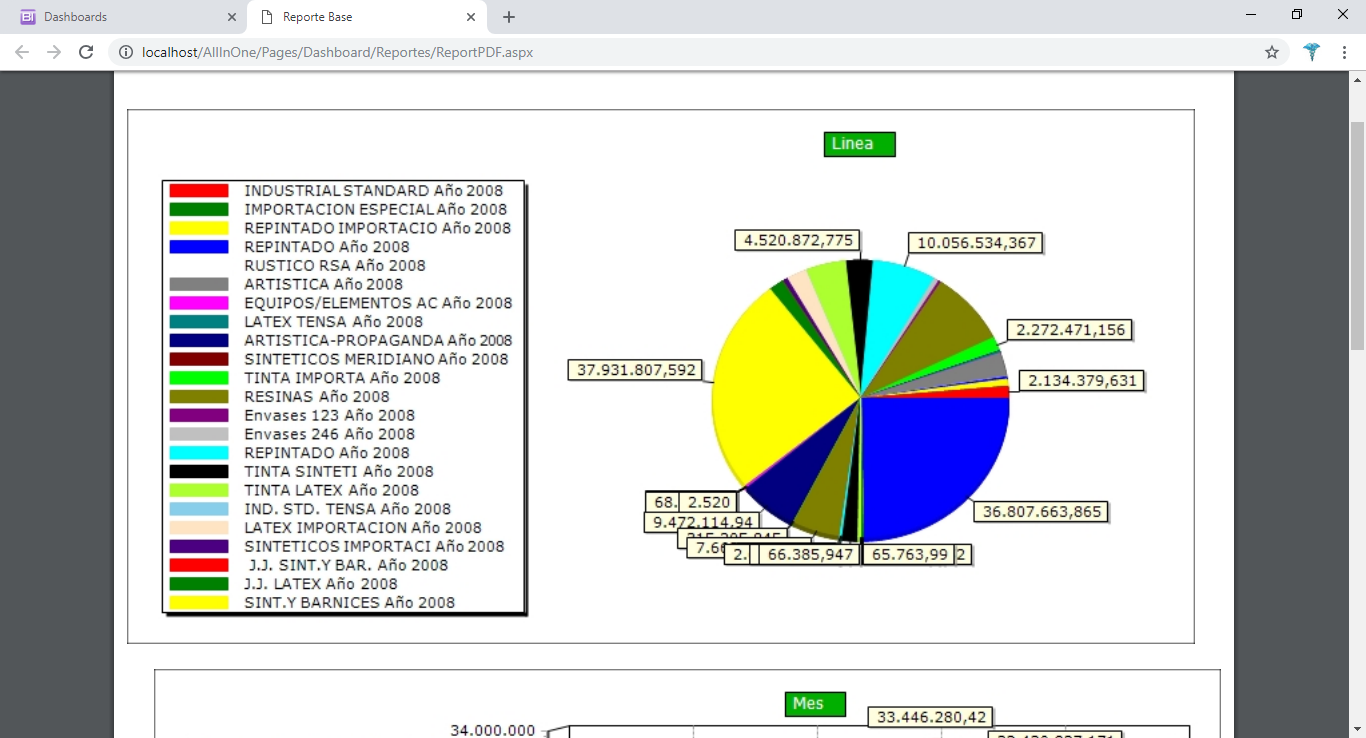

Hi, I have a problem when exporting a graphic to an image, the border even though it does not have it, it appears in the exported image.
I send attached the two images as an example.
The code:
mGrafico.Chart.Export.Image.JPEG.Height = vAlto;
mGrafico.Chart.Export.Image.JPEG.Width = vAncho;
mGrafico.Chart.Export.Image.JPEG.Quality = 100;
I'm using TeeChart 2018 web forms.
You should be able to eliminate this border by setting the Graphics3D.BufferStyle property to None, e.g.
			var oldStyle = tChart1.Graphics3D.BufferStyle;
			tChart1.Graphics3D.BufferStyle = Steema.TeeChart.Drawing.BufferStyle.None;
			var jpeg = tChart1.Export.Image.JPEG;
			jpeg.Quality = 100;
			jpeg.Height = 300;
			jpeg.Width = 600;
			jpeg.Save(@"C:\tmp\chart2.jpeg");
			tChart1.Graphics3D.BufferStyle = oldStyle;

Hi, it works fine.
thank you
