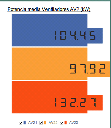

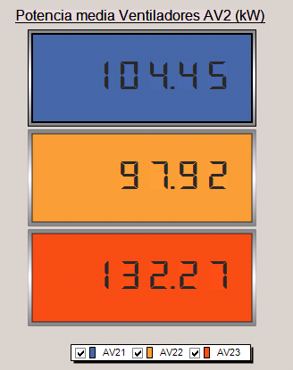

I have updated our Teechart versión (from 2014 to 2018)
Now, when I open a saved Gauge (saved with 2014) the appearance of it is not really good. How could I make it be shown as I can see in the older version?
I attach 2 images of a Gauge (shown in older version and shown in new version)
Old version:
New version:
Tony.

I have already solved it. The problem was in the marker position (the marker for the text in the gauge)
I dont know why, but in new versión the chart (previously saved in older versión) is opened with an extrange position out of limits of the rectangle. What I have done is only to place it by code when the window is loaded
